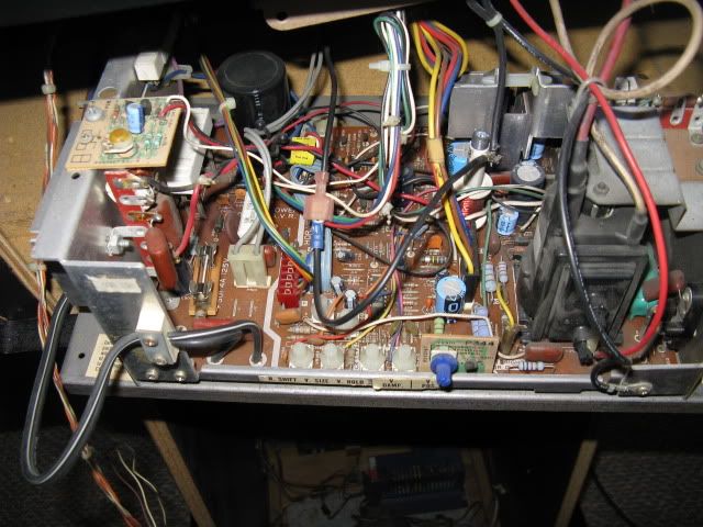

So I bought this 720 in non-working condition...but working prior to going into storage. After looking through everything and replacing all of the fuses I could, I still have nothing. I can coin it up and seem to be able to hear it play blind. I bought a second video PCB, as I just happened to come across one on E-bay and jumped on it. My original video PCB didn't seem to light up on powering up, but this one does...in neither case did it change the functioning of the monitor. Power's coming out of the switcher and transformer okay, and checked the end of the wire going into the monitor's PCB. I've replaced and reseated all of the wiring. I also removed and replaced the flyback, just in case there was something loose there. I'm not even getting a glow on the neck, and no humming whatsoever from the monitor...no arcing or anything. What do you guys think I should try next? Replace the caps? Flyback? All of the above? Keep in mind that even though I'm using all of these terms, my knowledge is EXTREMELY limited...only what I've picked up over the past few months. Thanks!

...but I can't really find that part on my board...I may just be blind. This is what I'm working with:

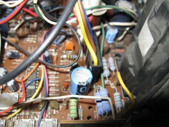

This big black cap looks a little corroded on the bottom left there (blurry...tough to focus)
Anything look really out of the ordinary? Where can I test B+? And before anyone points me to BYOAC FAQs, I just tried to register there, but I'm waiting and can't seem to find the FAQs...are they hidden when you're not logged in? I know this is asking a lot, but I can't do much else on this this weekend and my guy won't be here until at least monday, so I thought I'd try something. Thanks so much!

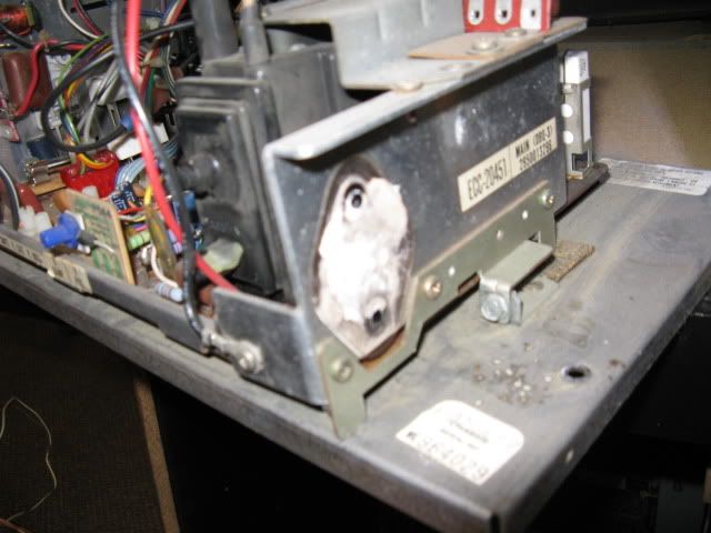

I'm reading through those FAQs and going through the monitor manual...I still can't figure out where to measure B+, so I guess I'm just stupid. In any case, while reading through another thread I saw that someone posted this picture of the same monitor:
Well, guess what mine looks like:
According to you, Peale, this is a "TO-3 style transistor".
Would this result in absolutely zero life to the monitor? Where's the easiest place to pick up one of these babies?
Heh... uh, I don't think that worked when it went into storage if that's missing... that's kinda important ;) . I believe that's Q352, which is the HOT (part # 2SD870). Bob Roberts should have them. You might ask if he's got screws for it too, since yours are missing.

I think the 25" used 2SD871...
I just checked the manual I have for the 25" k5515 and it says 2SD870.
And yeah... it definitely wouldn't work without that, though people don't typically pull those for no reason (unless maybe they needed it for another machine), so it seems likely something else is wrong with it.

Well on the side where it was previously mounted, there's some sort of substance that I can scrape off. Looks like Bondo or some sort of dried out adhesive. I supposed it could have just fallen off. That being the case, I would expect to have found it, but maybe not. As someone else had posted (the pic I borrowed showing the transistor in place), I guess these things can corrode...maybe the guy started recapping the monitor, saw the corrosion, removed it and didn't have a spare, and never got around to it? Guess I'll find out on monday...
that stuff you see is heat sink compound. helps transfer the heat from the HOT to the wall so it can disperse easier.
When you replace the transistor, don't forget to put a mica insulator between it and the side wall - otherwise you will blow the transistor, fuse, and maybe something else right away. Sometimes the parts suppliers don't include them...

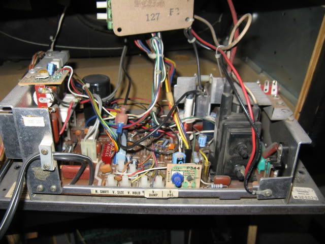

Well, as a follow-up to this, I finally got my transistor and the other transistor-looking thingy on the other side. Matched up the exact part numbers and had to order them from two different suppliers. Got new mica insulators and heat sink compound. Hooked them both up tonight....and nothing :( The TO3 transistor looking thingy on the left heats up, and I got a shock from it, but the 2sd870 transistor on the right doesn't get warm. I was really hoping that by just replacing these two parts, that would do the trick, but I still don't get a single hum or glow from the tube. I guess I now just need to go along the whole board and see what tests bad. Unfortunately, I don't really have the know-how for that one. Maybe I can call an old-school TV repairman? The guy I'm working with right now isn't great at monitors...but he can replace my caps, so I suppose I should move on to that as my next step.

Did you go through the entire chassis and check for cold solder? Also, it's possible that some of those new caps might have no been soldered in correctly or you have a broken trace.
