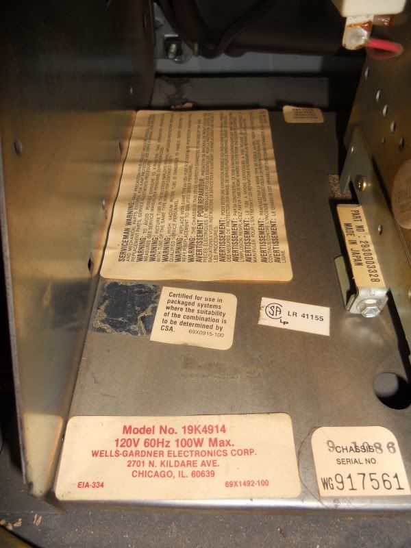

I just want to check to see if I have this correct:
WG K4914 = standard res
WG K4915 = med res
Is this right?
I have a Rolling Thunder & I'm trying to figure if it's a med or standard res game. The OG monitor for it is labeled K4914, but I'm wondering if it's actually a K4915.
That is correct.
What is the monitor problem? Do you see multiple images overlapped?
No, the OG monitor (labeled 4914) is just fine, but I had pulled it to use in my Rampage (which needed that specific monitor, apparently). I'm having trouble with a replacement monitor & was wondering if Rolling Thunder was actually Med-res.

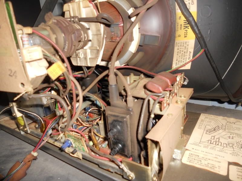

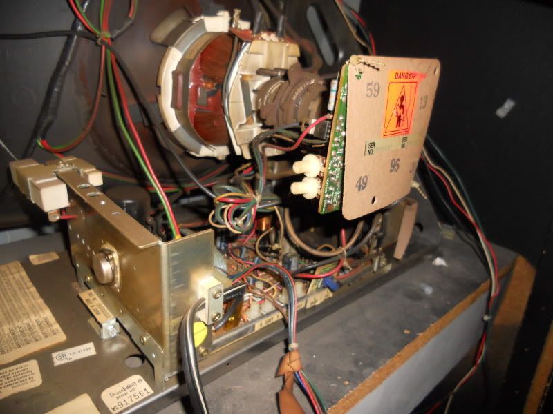

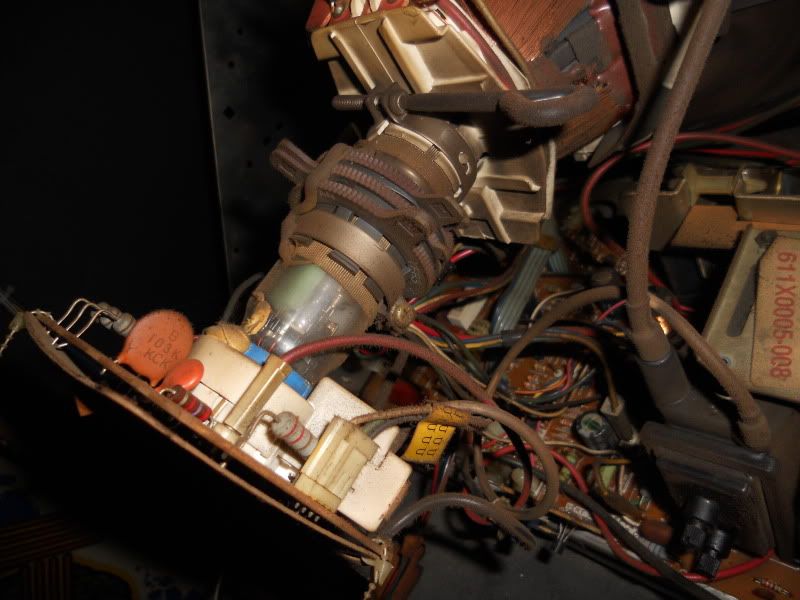

Here's some pics of my K4914 (labeled as)...
Is there anything here that would indicate it possibly being a K4915?
Rampage and Rolling Thunder are both definitely Standard resolution. What chassis did you use as a replacement? Did you use the original yoke or did you swap the yoke? What is it doing currently?
If it was a 4915, it would have a little circuit board mounted on top of the left side wall, like this one:
Could that board on yours be the board on mine with the blue knob? Different location, sort of under the flyback area... you can see it on 2-3 of the pics... especially the 2nd one. It's labeled P344?
Just checking...
Nope. In fact, on my pic, you can see that blue knob sticking out under the neckboard. That's a little board they put on later chassis' as a vert-position adjustment pot. Earlier chassis' had a jumper you had to move, just like the horizontal shift jumper.
BTW - that little board I mentioned is found on the K4915 (19" medium-res), K5501 (25" standard-res) and K5515 (25" medium-res). There are other differences between these three chassis to tell which is which, mainly having to do with the part number of the linearity coil and the values of a couple caps.
The standard-res K4900's don't have that small board, and have the linearity coil mounted on the chassis rather than on the side wall under that little board...
