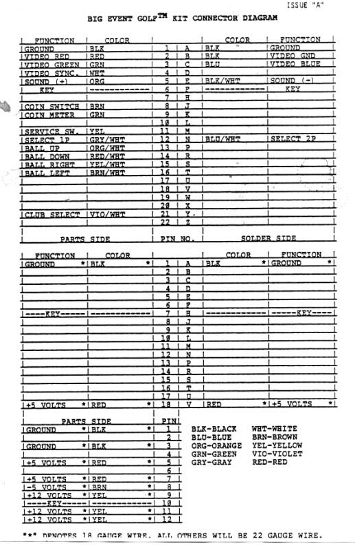

Ah yes. That's what the service button does. Your test switch slides and is usually right next to it. You might need to put it in test mode first...
Hmmm... That's missing too. There really is not circuit for testing including both the switch or the button. All I have identified on the pinout is the test switch, I'll look again, but didn't see any criteria for any other 'test' circuit stuff. Just "Service Sw" on the connector diagram, and "Test Mode" on the dip switch table. See attached.
Connector Diag:
Dip Switch Table:
