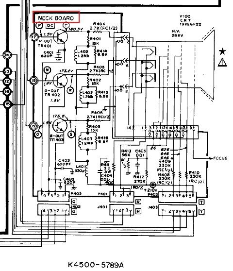

I still cannot find a brightness pot on the neckboard. I've attached a clip of the schematic for the neckboard section, and cannot find anything labeled "VRXXX" just in case.

Rather large update: After reviewing the schematic around the video interface card, I found that a key single wire was disconnected. It has been since I got the machine. I studied the schematic and plugged it in where it made sense, and bam! I've got my whites!!! So after that, a friend and I made adjustments and got it to a point of good color and the center being pretty well converged, but now the only remaining issue is that around the bordering edges, the colors are out of alignment. The 3 main color adjustments around the tube adjusted well to align most of the center area, but when I try to adjust convergence on say the bottom, top, right, or left... there is little to no difference. If anything, it makes the screen have a very slight wave with most of the adjustments. Almost like a sync issue. Are the pots bad / rusted / dirty? Should they be very significant in adjustment or only very minor?
