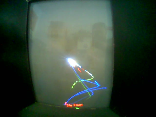

I have another thread on this but the more I look into this, the more I think it may be a monitor issue. [ http://forums.arcade-museum.com/showthread.php?t=148849&page=2 ]
Monitor had been working great when I got it. Board was bad but it played albeit with some glitches (associated with the board).
Sent board out to get fixed. During that time I had the cab on its side to do some cosmetic work.
Board came back, fired it up, played blind with (what is now once I turned the brightness up) a streak of light/color/motion from the lower left to the upper right.
WG6100 has the LV kit installed.
Ideas?
I know I posted this in your other thread, but I don't remember if you said you checked or not... but double check that none of the pins in the monitor's Molex connector have pushed their way out. Check both the harness and the monitor side connectors.
Check both your positive and negative power supply rails coming into and out of the LV2000.
-Ian
all the pins are good...Not sure how to check the voltage at the lv? there are two wires coming out, red and blck....I assume I check those?
Well, since you haven't posted a pic yet, I went and dug through some of my old 6100 problem pics. Does it look like this?
Ah, missed that you added it up there...
Have you tried fiddling with your X/Y pots on the game PCB to see if it changes the image any?
I appreciate you digging up the pic...Mine is a pretty straight line...It does change a bit (gets longer or shorter) when I adjust the pots...Beyond that, nothing
