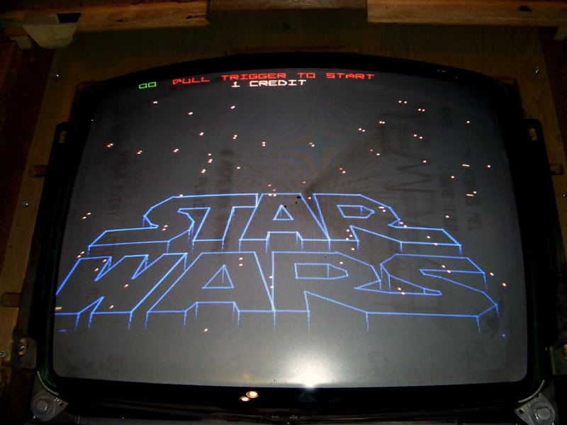

Notice what's going on to the left of the screen? What is causing that? Any suggestions?
I re-capped the 6100 last night. I dropped a LV6100 kit in to the low voltage section... which DID rectify some small issues but didn't rectify the major issue I am having... the left 2 to 2.5" of screen not showing anything.
It appears that when the vectors hit a certain spot to the left... they simply bunch up. When getting hit by a missile, for example, the screen lights up, but a "line" right at the location where the screen stops pops up super bright as if all the vectors that were supposed to cover the left 2"-2.5" all lit up in that one 1/16" to 1/8" vertical line. Another thing you can notice is when the stars are "coming at you"... they hit that spot in the screen then simply drop DOWN as if they can't go horizontal but still can go down).

This really looks like a pcb board issue where the DAC is messed up...just a guess. If I'm right it will not allow the voltage to swing properly above a certain point on the Y axis.
The best way to confirm this is to run it with your tempest.

Why pull the entire monitor. Just pull the deflection board (if they use the same monitor) from one and try it in the other. I doubt the HV section causes this, and also doubt it's one of the frame-mount transistors...

I can now confirm 100% that this IS in fact a MONITOR issue... not a PCB issue...
Here is my Tempest monitor in the Star Wars:
Any ideas?
For now, I've moved the bad monitor over to the Tempest where the issue is only noticeable between levels as during gameplay only about 2/3 of the screen is used...
But I'd sure like to fix the problem.
Did you swap boards between the two monitors to narrow down the problem - like I said earlier?
Unless one of the voltages for the deflection circuit is bad.
Still, try the deflection board first - like I said way back in post #5...
