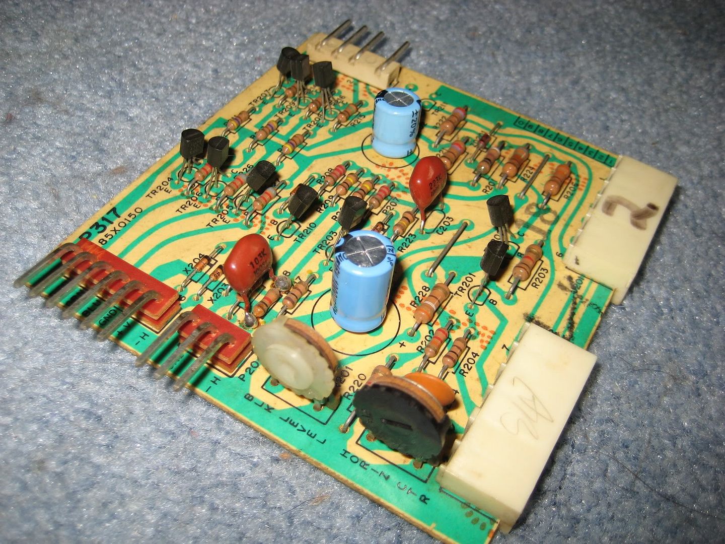

Some K4600s had different interface cards in them, with various pinouts. I'm pretty sure the later ones had the now "standard" pinout, and should be plug-compatible with newer monitors (like a K4900).
Look at your interface card (the one the video connectors plug into) and see what "P" number it has. According to this: http://www.ionpool.net/arcade/tech/19K4600_pinout.txt if you have a P306, P317 or even the P298, it should be the same as the K4900. If, however, you've got a P297 or P302, a little re-wiring may be needed.

The 4600 yoke and 4900 yoke are NOT the same, so you can use the same tube, but have to swap the yoke. Once you swap the yoke, you can put whichever chassis that matches it on it, as the yoke connector will match the chasss. Video connectors and power connectors from the game will plug into both with no changes, assuming no one has altered the original power connectors.
Also, the chassis mount to the frame in different ways, so you may have to adapt or swap the frame for an easy swap....

you'll also need to make sure the new K4900 has a frame that's compatible with the Bosconian cabinet... it needs to be either a horizontal mount or universal mount as it must have the mounting brackets on the sides of the monitor, not the top and bottom. chances are pretty good that it'll be correct but it can't hurt to double check.
Thank you for the continued feed of information. Turns out after digging into my machine some more that I have a 4606 vertical type monitor and tube mounted on a 4626 chassis with a recent re-cap. I have not identified the interface yet but it maybe the P317 after seing the black knob on it.
The 4903 I am looking at is a horz. mount with the mount tabs on the sides, so the mounting aspect should be easy.
