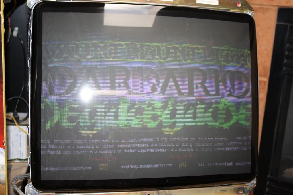

I just got this 7401, just got this K7400 and it has some weird issue displaying a picture.
i ordered a cap kit from bob today but im wondering if i should be looking at other issues.
Ive tried to adjust the pots on the remote board but i have not tried to adjust the pots on the actual chassis.

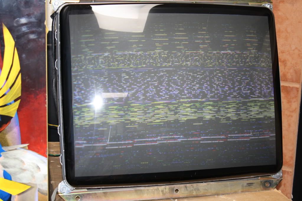

Hmmm... you're running guantlet at Std Res right? (I forget which dipswitch to change)
Looks a bit like a medium res signal going to a std res monitor...
the K7500 and K7400 will have ONE cap in either spot. meaning, the K7500 has a cap in one spot, and the other is empty, and vice versa for the K7400.
I can't remember specifically which one is which, so I hope you remember which one needs to get pulled out.
the "extra caps" are for a pincushion board if you have a 27" or larger tube. I can't remember if those Gauntlets had 25s or 27s... they're like the other Midway cabs but a little different.
now I'm not sure if having that extra cap would cause your ticking issue, but if you happened to pop the HOT having that cap in there, that will cause your ticking. without horizontal deflection, you can't have high voltage. the only other thing I can think of is that you made an error in your solder work elsewhere, perhaps a solder bridge between two joints.
I'm no scholar on the subject, but I suspect that the primary difference between the standard resolution K7400 and medium resolution K7500 is the jumper wire arrangement in the middle of the chassis and that either-or cap placement. there's probably some other shit that's different, but I'm also going to assume you blew the HOT having that other cap in the circuit, if it's even attached to horizontal deflection. I don't memorize anything with these at all, soo....

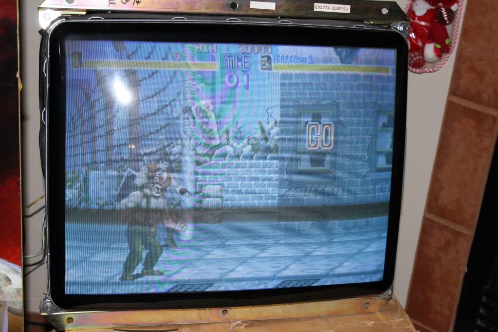

Awesome! I guess it works just fine.
The only thing is the top left and right corners are blurry even after adjusting the focus on the flyback. i got all the pots dailed in as good as i could and it looks great besides the corners...
Blurred corners or poor corner convergence is symptomatic of a failing flyback with these. Does your focus or screen adjustments move on their own after its been on for 20 mins or so?
i dont think i had it on for more than 20 minuets when testing so ill have to check that out but it didnt seem to change after adjusting everything, ill have to try that.
