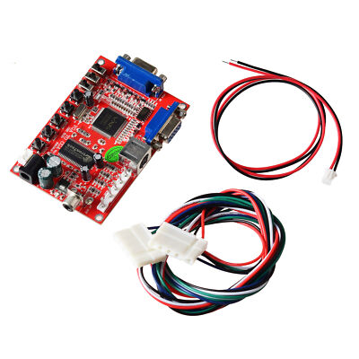

I saw your previous post on arcade controls. Can you still use a VGA source? I know I have used these converters to convert VGA video from a PC to a CGA monitor for projects like MAME. Works great.

Yea, I can convert my HDMI output from the Digital Video Player to VGA. So you are saying just use this and don't try to use those other boards? If this works where do I send the check! ;) thanks so much. Still need to find a power connector for the monitor. This feels like progress. :D

If you get that converter, the output video pins on the converter are: RGB as normal, next pin is ground and the last one (Sync) has to go to both negative H Sync and negative V Sync.

Wanted to let you know that your suggestion worked great! Parts came today and we got it wired up and working. Thanks again!! The center monitor is the WG. The picture looks bad but that is the result of taking a picture of a CRT display. The picture actually looks really good. The monitors to the left and right are connected to the GBS-8100 via VGA and Composite video to make sure we had a good signal.
