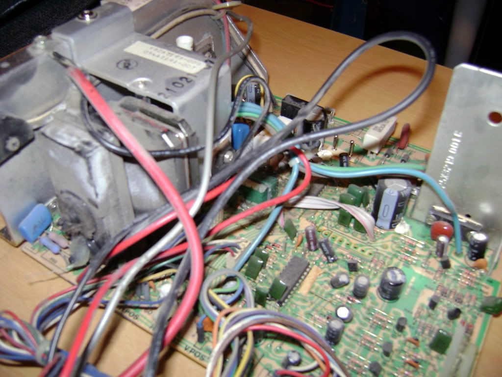

Acquired a Street Fighter II Hyper cab with one of these monitors in it.
The Fuse was blown, I replaced it. It gets red hot and blows again. I'm not to familiar with these monitors so where is a good place to start troubleshooting.
When the monitor starts to blow the fuse, there is NO crackling, no hum and NO high pitch whine(as other members had said their monitor was doing when it blew the fuse), there is just nothing, it just slowly builds up(hot fuse) and burns the fuse out.
What do you suggest I look at first. I get 120v out of the ISO.

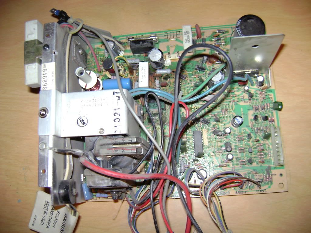

I got the damn thing out of the cab(very heavy and the cabinet is hard to deal with) I don't see anything obvious looking at the main mon board or neck board. The flyback looks ok(no burn) so not really sure what the next step is. Any help would be appreciated. Thanks!!

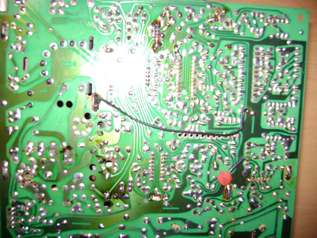

I checked the HOT and it ohms to 1.57. I've checked the R101 (that other links recommended) it checked out ok and I reflowed just to make sure. The fly physically looks good. R98 checks out ok. The Mylar caps check out ok. Replaced fuse, still blows it though..
Now this monitor has been in the cabinet since birth. And as far as I can tell has always ran off of an ISO.
However, obviously it has been serviced since as the Horizontal Coil looks very new. And it looks like there was a MOD done to it (PIC3). Not sure what it does or if this was standard.

I will check the diodes tomorrow(upper right hand corner of the board(pic 1) right?) as I will un-solder one leg to make sure that they are good(only way really). I will also check c36(looks like two caps in parallel).

Mods
By the way, your pic 3 (which shows the mods), I think this is from the factory. I have a board with the same mods. Must have been an 'improvement' after the boards were made.....

In your very first pic - you see in the dead center some resistors where the board is baked brown. Thats where I would start. Check those resistors for bad solder connections and the resistors themsevles with one leg pulled on each (to get a good reading).
Hard to tell by the pic - but that medium sized cap right next to those resistors looks swollen...if so thats gotta go (chances are the whole chassis needs capping).
