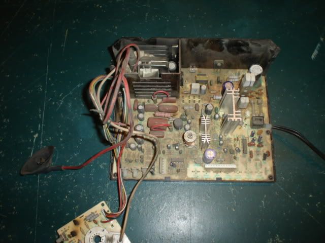

ok i have had a wg 25k7191 sitting around with a stuck on green gun
shot it with my rejuve today and now i have full range of color
after installing it intomy neo geo cab i have noticed the whole screen is doing the wiggle dance no ammount of adjusting is removing the wiggle dance so im going to recap the monitor
now for some ?
first i need a manual for this monitor i the k7xxx manuals i have pulled up do not look like this monitor my remote board has 7 adjustment pots allong with a deguass switch none of the manuals i have found show this all have 6 pots on the remote board and no deguas switch

You have a 25" k7000 series monitor and it uses the standard K7000 capkit.
This website has the schematic:
http://jstookey.com/arcade/WG_25k7191/
You use the schematic from the above site in conjunction with the K7000 manual.
Remember, some 7191 monitors had a remote adjust board and some do not & still have the controls on the main board like a conventional 19" K7000 would.

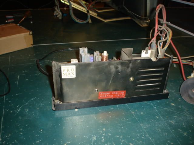

ok i think i may have a aftermarket chassis on this monitor as after pulling the chassis board i see a sticker that says power max and everything on the board is in korean and the underside has no locations listed on it
would this still be a wg chassis
i did find a buldging 100 uf @ 160 v cap so i replaced it and the wiggle is now gone but im having problemns with the monitor having bleed seems blue and white bleed no matter how much i adjust the pots i get bled on them bleed guess i need to confirm this is a wg chassis and not a aftermarket then totaly recap it
thanks
also i have some contact cleaner with lube built in is this ok to use on my scratchy pots
If it says, "PROMAX" and a model of C10xx then it is an aftermarket Wei-ya chassis, maybe a 1820HR.
Pictures would help.

it is indeed a pro max chassis

the horz width coil on this chassis is blocked off so it can not be adjusted( there is a black slug inside the coil to prevent any tools being inserted)
there is a adjustment on the remote board for horz width but it does nothing at all(cleaned it and replaced it with no affect )
my screen is wayyyy to wide on this neo geo 2 slot
what next
Check the bottom of that chassis for a hole that allows you to access the width coil from underneath....
Yup that's a Wei-ya chassis alright. Probably an 1820HR or a 1220HR model (should be silkscreened on the foil side somewhere near the fuseholder clips). The remote board should be marked "620RC". Neckboard should be marked "428H". Likely a model 1220 is what you have.
This chassis may have a "horiz size" transistor that might be shorted causing too wide of a picture. Are you certain you replaced the electrolytic capacitors with the exact values? A wrong value could also cause width problems. Check the remove board connectors for bad solder joints. On the main board is a jumper wire you can move beteeen two different posts to select width range: N (narrower) or W (wider). Perhaps you need to move this to the N post (with power off naturally! ).

after screwing around a bit more if i wigle move the remote board the screen will fix itself (or when i power off and back on) width wise so tommorow ill pull the chassis again and reflow the headers for the remote board and also check the n/w jumper on the board and se what its set to

got her all up and running now
after reflowing the header pins on the chassis and remote board everyting works like it should
