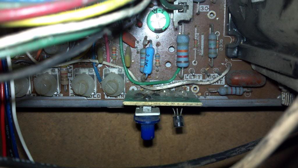

finally got a couple decent pics of it:
here is where the jumper is soldered to the chassis and where it goes to on the 3 pins adjust the image.
the center pin does nothing. it is just a place holder.
the two outer pins move the image.
only connect the jumper to one of the pins at a time.

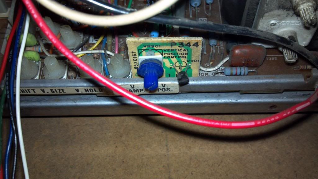

That wont help me with my vertical position problem. Those posts are the horizontal posts and are even labeled as such. The vertical ones are there too, and labeled, they just have that pot soldered to them. Ill have to dig up a pic of someones 4900 with no pot to show you what i mean.

I assume you have already re-capped this monitor?
If so, then the transistor on the vertical position board probably does not have enough gain and should be replaced. This assumes the vertical position pot is ok.
yes, i have re-capped. it has a really nice picture and centering vertically is the only issue i have with it. the pot has a full range, in other words, it shifts the image from one end of the range to the other end of the range.

Adjusting that pot allows you to center the picture vertically. If it isn't doing anything transistor Q901 on the vertical position board could be bad.

Is the daughter board removable? I tried to pull it out gently but it won't budge (that's what she said). I don't want to be rough, break something and make things worse.
no it does not come off.
it is soldered to the chassis.
test the transistor next to the pot it may be bad.

I had this exact same problem with my Time Pilot (WG K4951) after I installed a cap kit. The vertical postion pot could not get the screen far enough left.
Looked high and low on the internet and didn't find much mention of this particular problem, except for this thread which was kind of left unresolved.
Buffet's last comment about the transistor next to the vertical position pot potentially being bad made sense to me so I researched it and found a modern replacement which I bought here:
http://www.ebay.com/itm/NEW-NTE194-NPN-TRANSISTOR-TO92-ECG194-/262049356461
Installed the new transistor this evening and the problem was solved for $4.18 and about 30 minutes total, including removing the chassis and putting it back.
