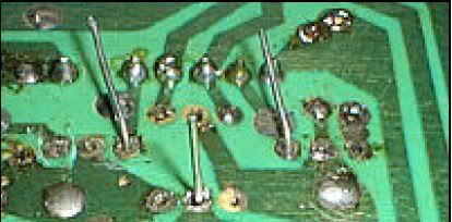

Does anyone know where there's a closeup photo of the front or back of the deflection board for the 6100? Especially the area in the low-voltage section near the connector in the corner where F100 is?
This is the part that would be replaced by the LV2000 if I had one. I wasn't planning to put one in but to just replace the components. However, mine is badly scorched and I think I'm going to have to reconstruct a couple traces.
So an images showing the actual traces would be veeeery helpful. If I can't find one online I can disassemble one of my others, but there's gotta be one out there. I just can't find it!
from the lv2000 instructions:
The traces follow the green on the top side:
Here's the bottom:
Now why didn't I think to look there? I dug through the manual and searched around all over...but didn't remember to look there. Thank you kind sir.
