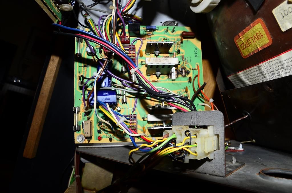

OK guys, no flashing spot killer LED. Here are some big pics for close inspection...
I can tell you that something smelled hot after 4-5 mins 'on'/ C901 looks bulged on its top. Do you see anything else?

Okay. No spot killer, and an HV cap is bulging..
Something is way wrong with your chassis.
If C901 is bulging, your positive side HV supply has AC in it.
Replace that cap, then check D101-103 for shorts on the LV supply board.
Then check Q102 for a short, along with ZD100, D104, and Q100.
That is one of the weirdest capacitor setups I've ever seen on your deflection PCB. I've never seen those types of caps used there before . . . also you are going to want to install a LV2000 kit onto that deflection PCB, it will safe you a ton of time and heartache in the future!
I am confused now. Drake refers to the LV board, disjaukifa says install an LV2000 kit. Are you guys speaking about the same thing? I don't really know. If I remember correctly (and might be wrong), the seller said that he installed the low voltage driver for the monitor.
The larger monitor board with the 2 blue capacitors on their side is the low voltage "lv" or deflection board. There is a small board made to replace a small section of parts on that board called an lv2000 or lv6100 depending on who makes it. You can google for it. By replacing some resistors, diodes, and capacitors in that section of the deflection board, you prevent a lot of troubleshooting issues.
If you look at the metal box, that is the Hv section or high voltage cage. You have a bulging capacitor in there. It needs replacing. I would imagine there are other issues. Looks like it has been gone thru but you need to check the work that was done. I would recommend reading the 6100faq to get an idea of the mods that are recommended.
Also, if something smelled hot......it was probably the resistor on the deflection board smoking because you didn't have the degaussing coil /circuit hooked up. It is the small two hole connector hooked up to the tube near the back of the deflection board.

I am only NOW getting into repair mode. I replaced the caps on the bulged cap board. I turned the monitor/driver boards unit over and found one yellow wire undone from its transistor (one of the four mounted on the metal chassis), so I re-soldered that back together.

I just started it up and I heard a pop. It was C901 giving up the ghost. It (or something) has a strange odor- sort of bleachy- ideas?
It's polarity on the board is/was correct. Ideas?
Also, still no video and the game has a hum now that I believe is new. I heard no audio in the short time that I had it up before 901 blew.
The cap C901 is a 35V rated cap
It needs replacing, as it's blown
If more than 35V comes through (from the deflection board) to the HV board, C901 will blow again.
The diagram says there is meant to be 26.5V across that cap
So you need to check the things WindDrake said
