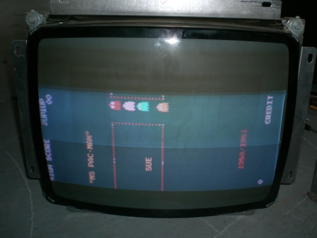

K49xx or K4900 - vertical collapse. Just did a cap kit, reflowed yoke connector pins, video input pins, Q302 and Q303 pins, and reflowed the sand resistors in the rear corner. I'm pretty sure I have (a) failed component(s) in the vertical output area.
Can anyone give next steps on what to do? Should I pull Q302 and/or Q303 and test them using the diode test on my MM, or can I just test them on the board?

q302 and 303 is a good start, did you have vertical collaspe b4 the cap kit. if so check for hairline cracks in that area or cold solder joints.
The collapse was there before I started the cap kit.
Replaced Q302 and Q303, as well as IC501, testing between each component replacement.
Metered the resistors, and they are ok.
Reflowed a lot of joints.
Still no change.
I need to see a picture on this tube to rule out any issue with the tube and/or yoke.
The tube and yoke are from a 19K5603 chassis which smoked the flyback, but putting the K5603 and the K4900 next to each other, they appear identical, so I figured the tube would be an OK candidate to drop in another 4900. Perhaps that's my error? Is the 19K5603 a medium resolution chassis? Would that matter?
I have a 4900 in my Ms Pac, so I can pull it and test the chassis on that tube I guess. I will also test the 4900 from my Ms Pac on this tube from the 5603 to make sure my tube/yoke is OK.
Just keep following traces around? Try to find a broken connection somewhere?
I'd do the swap and test that its not a compatability issue first.
The yoke is NOT compatible. You are not looking at vertical collapse although it would seem like it. Check out the wave, vertical collapse would be a solid straight line.

A vertical collapse could be from resistor R313 going open. This one is 470 ohm at 7 watts. Usually need to unsolder it to check it though.

I didn't trust my late night trace inspection last night, so I went over the chassis again, wiggling all pins all the way to the yoke pins. When I got to the yoke pins, I got nervous. I pulled out the meter and tested continuity from the pins through to the board. One pin was good, the other was not. BINGO.
I HAD re-soldered the pins, but obviously there was old solder beneath, because my added solder did not fix the joints. I sucked all of the solder off, resoldered all 4 pins and was greeted with this on my tube:
Well, at least I fixed the deflection problem anyway. But alas, this tube's yoke is DEFINITELY for a medium resolution chassis. So, I'll have to pull this yoke and install one that's compatible with this chassis.

So, long story short: cold solder joints on the yoke connector pins for the vertical.
I stand corrected. The yoke that was on that tube WAS compatible. I got some good adjustment advise from Modessitt.
I was able to adjust the monitor to arrive at a perfect picture. Looks great in my Neo Geo cab now. I'll shoot a pic later this week and update this thread.
