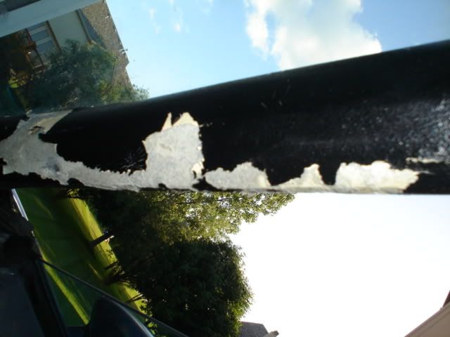

Can someone please tell me how the hell the canopy mounts to this unit(on the chair)? As far as the plastic, can you use bondo to fill scratches and then paint with Krylon fusion? I am sure I will think of others to ask...
do not use kyrlon fusion it sucks for plastics use sem or color bond brand paints
the fusion paint will flake off after time and can actually dry out the plastics causing it to break down
here is what fusion does to plastic over time
i ahve done auto and small aircraft custom interior's for about 8 years and have seen many cars that have been painted with that fusin paint and they always look like the above pic
we used the sem or color bond brands because they actually bond/dye the plastics instead of just covering it up
you can find the sem and color bond paints in pre mixed spray cans or custom match for spray guns at your local auto piant suply store
