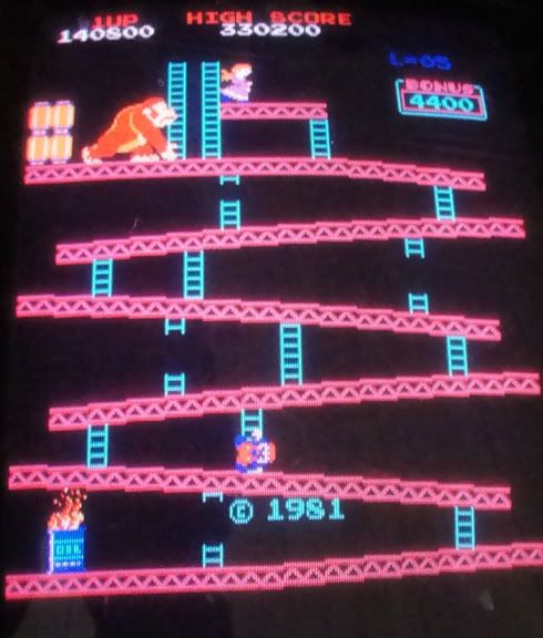

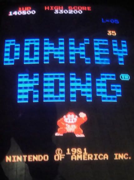

This just happened while a customer was about to play Donkey Kong:
Notice 35 in the top right corner:
and @ 1981 in the center bottom while the game demo plays:
for some reason this only showed up during the attract screens but not during gameplay. Any reason? Will it get worse? HELP!

now in 5th Place is read @1981 . Each time the attract screen comes on, it's a different glitch and it doesn't always happen.
Make sure all your chips are seated fully. Push down on them. I just had some random shit on a DK, pushed on all the socketed chips, and now it works fine (well, it needs a monitor rebuild)...
Thats what I thought. I'll see if I can get here early enough tomorrow to work on it. Thanks!
