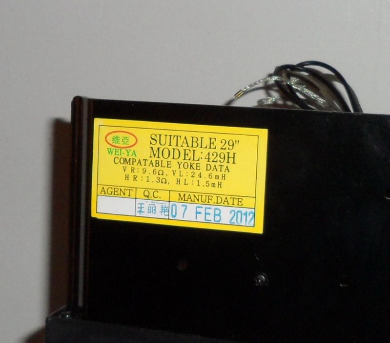

Is there a model number on this chassis?
For a 25" chassis that requires an isolation transformer, it should be model 825H (all controls are on the main board) or 825HR (has a remote adjust board).
The model 826H is for 27" tubes.

M1092HR

Here is the label in the chassis...

I haven't heard of those model numbers (429H and 1092HR) and I have no information on them. Judging from the box labeling you posted, it looks like it needs an isolation transformer.
