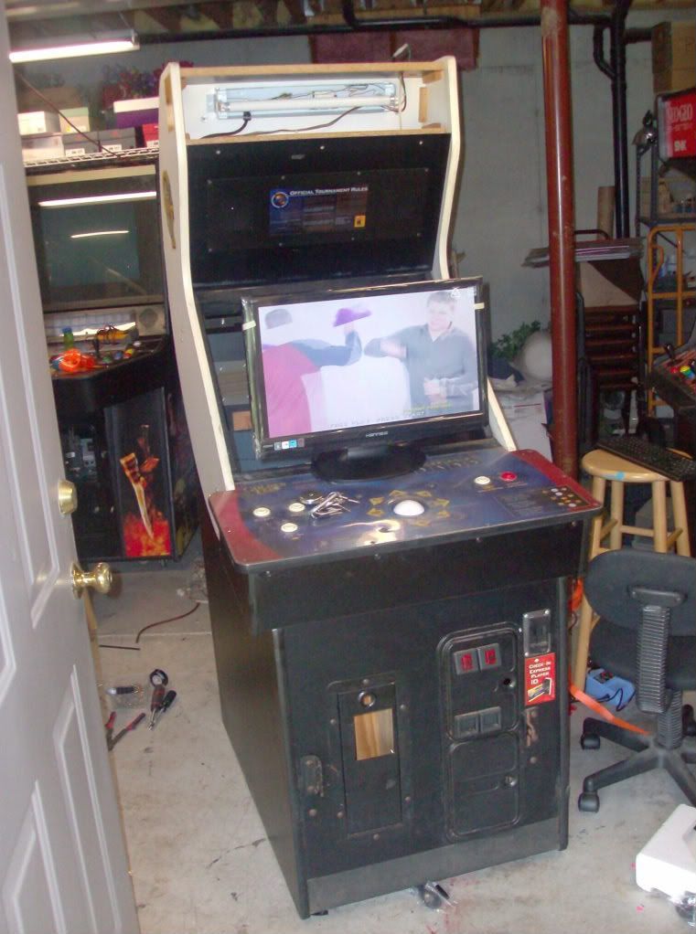

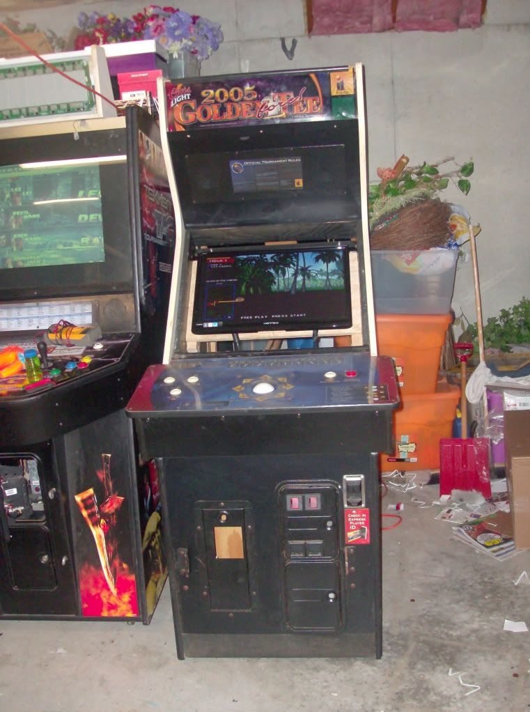

for 200$ and some work i now have a sweet golden tee 2005
picked up 5 golden 2 2005 boards from a local klover
traded in 4 boards for a 2k5 harddrive and a complete cab sans monitor
took her home and put everything togather and since i dont have any spare working 25 inch monitors i tested everything with a 19 inch lcd
with everything working good i decided its time to go grab a nice lcd
went to a local discount pc store and picked up a nice acer 24 inch for 170$

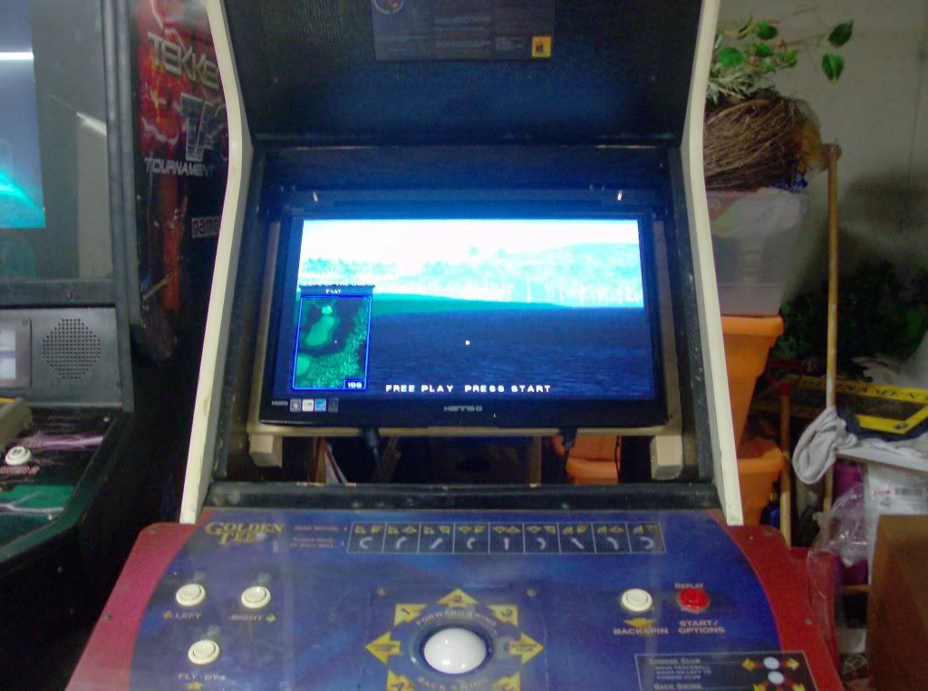

got it home pluged it in and damn it wont dectect a signal from the game board (damn med res siginal)
ran back to the pc store to return the acer and brought the pcb,hd, and ps with me this time
finaly after 2 other monitors i was able to get a hanspree 24 inch to sync up dumped down 200$ for the bad boy(even after my 10% discount )
got her home and got to work making some mounts
now here i sit with a playable game
(btw man the lcd looks nice in this game lol)
first thing tommorow im going to go pick up some matte board and have some plexi cut to make a bezl and thn i need to fab a plate to cover up the dba accptor slot and shes all done

Did that LCD work out of the box or do you have a converter in there?
lcd works right out of the box but it took me 2 diffrent lcd's to get one to sync up to the game
this one is a hanspre or somthing like that
the acer would not detect a siginal
and my test monitor a lenovo branded 19 inch synced right up as well
the gt boards run on a 3dfx pci based graffix card with a vga connector but are still outputing a low med res siginal so only certian lcd monitors will sync
