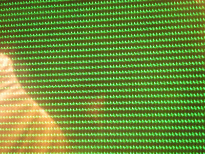

Hi All,
I have a CPS2 Marvel Versus Capcom A&B board set. When the cabinet is powered on I get a slightly green screen. I figured this was a sucide battery issue, but when I checked the voltage it was over 3v. Does anyone know a way of checking to make sure the A board is working and that the B board is sucided? I have been watching ebay in the hopes of pickingm up a cheap working A&B board set, but I would be much happier if I could just get this one working. I just don't want to spend the money to have it phoniexed if one of the boards is broken.

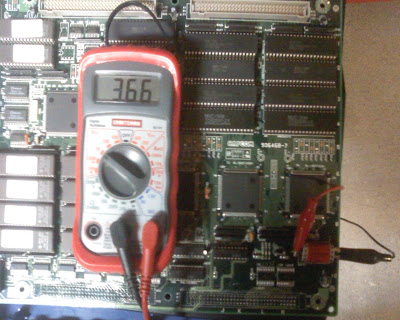

I am thinking that there is something else wrong with it, check out the voltage readings from the battery:
This is what is displayed onscreen when powered up (Close-up):

I don't normally through money at a problem, I like to fix things myself. In this case it is a hassle since the battery is reading 3.6v and then there is the hassle of burning a chip to tell me if it has sucided, then to send off to have phoenixed. It will be much easier to have a board I know that I working phoenixed. But in reality I will just add an extra battery so I won't have to.

so you know, if your battery suicided, it will give you a dark blue screen. I did a battery swap on my SFA2 (and SFA3 too for that matter) and when I installed it into my cab, it blue screened. I thought I fucked up the battery swap, but you have to REALLY smash the two boards together tight.
technically speaking, I want to say since the boards weren't seated right, it wasn't able to do the decryption (when the battery dies, the board loses the decryption code, rendering it unable to "load" the game) ... but luckily the fix was easy.
you would think with such a design though that the boards wouldn't be so flimsy on the inside to allow for that to happen. but those fancy clips for the sides of the casings? yeah... those are your friends. trust me.
your issue looks like something else. if you don't wanna take the whole thing apart, just try blasting out the connectors with a can of air and possibly sweep them out with a toothbrush like I suggested before. you might just have a shitty connection from age.

for the hell of it, is your +5 set right on your power supply?
That is good to know -- I am glad I bought a new board. When I got the cabinet the A and B boards were taken out of the case and rammed together. The cabinet is incredibly clean and looks brand new. The connectors are super clean too.
My +5v is reading 5.06 volts. That is about right, right?
5.06 should be sufficient. since it's impractical for me to test 60+ power supplies for our games, I can sense when the exhibited behavior is power-related and throw my meter on it. I've had to replace both power supplies in my Daytona USA twin. periodically the game after being on for a few hours would scramble up the screens, and was even more obvious by the fact that the two linked games would be out of sync. a test on one side showed up at 5.50(!)V and the other was real low, about 5.02V (gotta remember those boardsets consist of about 5 interlocked boards -- lot of mouths to feed).
likewise, our Road Burners was right next to my SFA3 machine, and I was playing SFA3 and noticed that Road Burners just kind of said "screw you" in the attract mode and flashed a hard disk error. now I knew the power supply was suspect, because when we got that game as part of a huge game lot we purchased, I noticed the cooling fan in the power supply was locked up and dead. friend of mine works for Best Buy, he had some extra 80mm fans laying around his house, so I swapped a new one in. would you believe that game worked for about 11 months with a +5 set at 4.82V ??? the hard drive ran off the board power connector! you can tell the power supply is shot when if you adjust the +5 pot and you can't get it beyond 5.05V. this one, luckily, adjusted out nice. it's just got mileage on it. gotta figure these video games we got are 10-15 years old, lot of them with original equipment still.
stranger things have happened, though. I have Randy Fromm's Blue Book of Really Good Technical Stuff or whatever the hell the title is, and read a story about a WWF WrestleMania game where the +5 was set UNDER 5.00V and the game worked fine. when the power supply was bumped up to what I think Fromm typically uses (5.10V) the game started resetting and exhibiting all kinds of strange behaviors. so there's some game hardware out there that can function perfectly fine even when the +5 is set too low, and there's obviously hardware out there that demands a little bit more.
I'd try bumping your +5 up to 5.15V, see if there's any change. there probably won't be. if you're uncomfortable making this adjustment, then don't mess with it, it probably won't make a difference anyway. case in point, my Daytona that was pushing 5.50V ? yeah, broken +5 adjustment pot. the power supply bottomed out to 0.03V, after which I immediately cut the power. older PSU's can be fickle like that, but I understand they're not exactly the cheapest item to replace, Daytona demands one of the beefier 200W Happ units, but it's a very important component all at the same time.
shitty power supplies can be the difference between your game working ok and your game DYING.
sorry for the long post. thought I'd throw some more anecdotes from my year of doing this tech shit at you. I guess it's worth noting that I learned how to do it from my vast computer knowledge and spending my entire life playing games in our past arcades (we had a grocery store with like this video game cellar dwelling, and even had the cockpit versions of Sinistar and Star Wars in it!)
Thanks I bumped it up, no difference. I figure it is dead, since I am getting a replacement anyway I won't mess with it anymore. Do you think I should try the good A and B board in the this one to figure out which part is bad? Or do you think it is foolish and risk the chance to ruining the good A/B board set?
