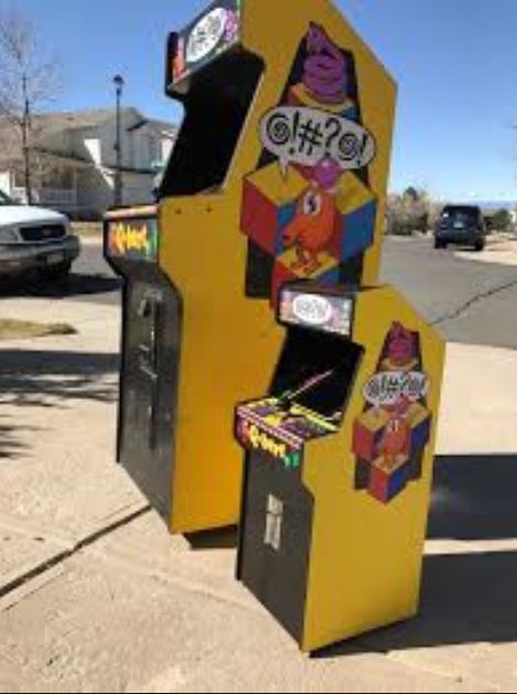

Just wondering if there ever was a Qbert cabaret made? I've seen some custom cabinets made, but did it ever officially exist?
And how much smaller were cabarets from full size cabinets? 15% 20% smaller? I'm in the process of building a new Qbert and would like to build a scale size cabaret of the cabinet. Just need the measurements of the cabaret.
Any suggestions?
There was no production cabaret made. Someone here built a custom mini Qbert, but I forget who, and can't find the thread. I'm sure someone will chime in.

Sorry for the low quality pic.. Here it is. I saw it for sale inthe LA area and didnt know it was custom build.

That same cab (or one just like it) has been for sale in LA for more than a year. I think he has made a bunch of different machines with that same basic cabinet shape. I talked to him when the ad first went up and he confirmed it was a custom build.
There was no production Q*Bert cabaret or any other Gottlieb cabaret but there was at least one prototype/test game. I played it in the Chicago area in the 80's.
I believe there was one obscured photograph of the side of it that someone took at the AMOA trade show. I'll have to dig for it.
