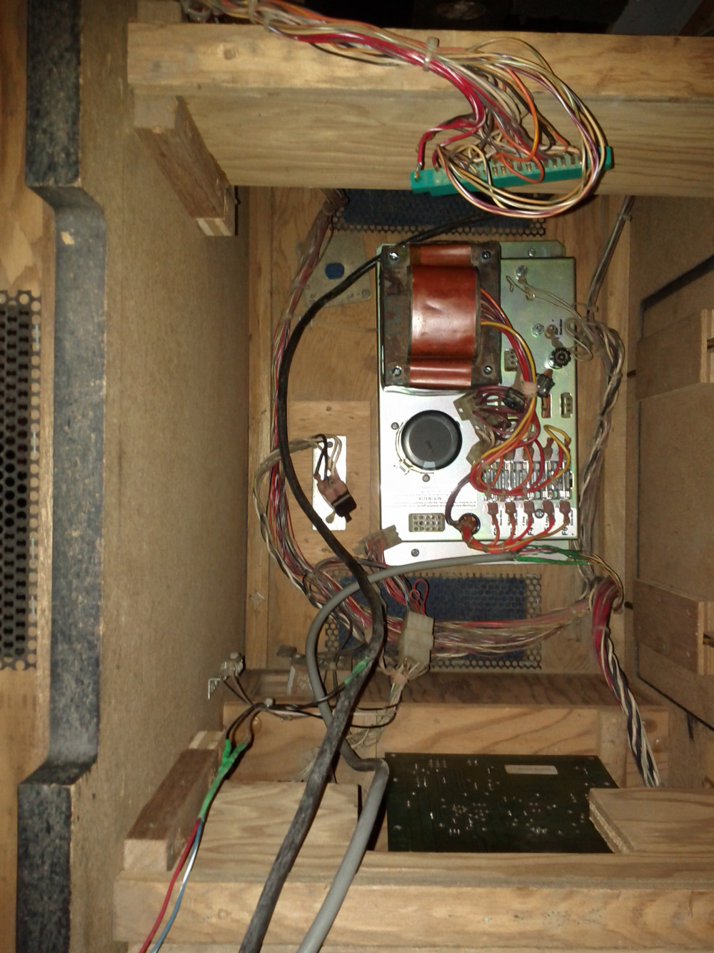

FWIW - for what it's worth ... my WL CT brick is shielded. :)

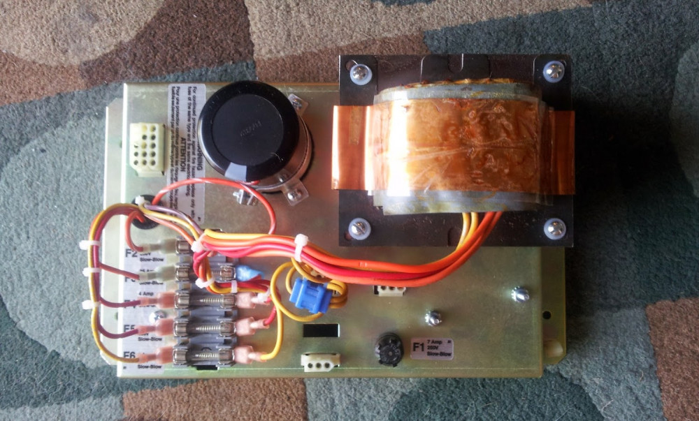

Here's an early pic during its restoration ->
Is that copper band around the brick the shielding? If so, then the brick I just put in does have it.
No. All bricks have that copper strip. It's just painted on some of them.
The shielding is more of a plastic-looking coating that is on the main iron of the transformer. Unshielded ones look like painted metal. Shielded ones look plasticized, though I don't know what the actual shielding is. (Maybe just a thin wrapping of something like mu-metal).
I'm still not convinced the shielding does anything, though I'm open to more data. But this case shows that a standard 120V raster brick can be retrofitted into a 100V cocktail with the appropriate wiring mods.
Yes, the EMI shield is copper. Proximity of the magnetic field to the CRT is much worse in a cocktail than an upright.
Here's someone else's pretty pics.
I don't think this is true. All bricks have the copper strip.

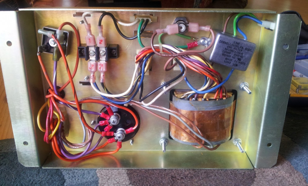

Not all of them have the coating. See pics here, particularly the Warlords cocktail brick, vs the others. There's a material wrapped around the iron that the others don't have:
