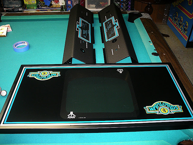

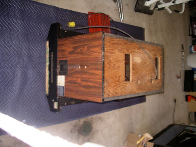

Here she is when I picked it up.
Real nice shape, needs new overlays and has some rust from being stored.
I ordered new glass and overlays.
A big thanks to Darrin for making these awesome reproduction pieces available and bringing them with to last years Holiday Lunch gathering, and to MrBill08 for carefully bringing them back (I could not make the lunch).
I tore it down over this past weekend
Here it is after removing all the metal

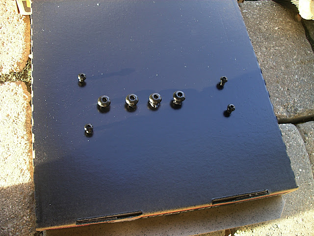

Painted all my visible bolts

New glass in the frame
Some minor cleanup and the buttons look new again
Before and after
CPO install went without a hitch
They look absolutely bitchin
Not a single air bubble (thats a first for me)
