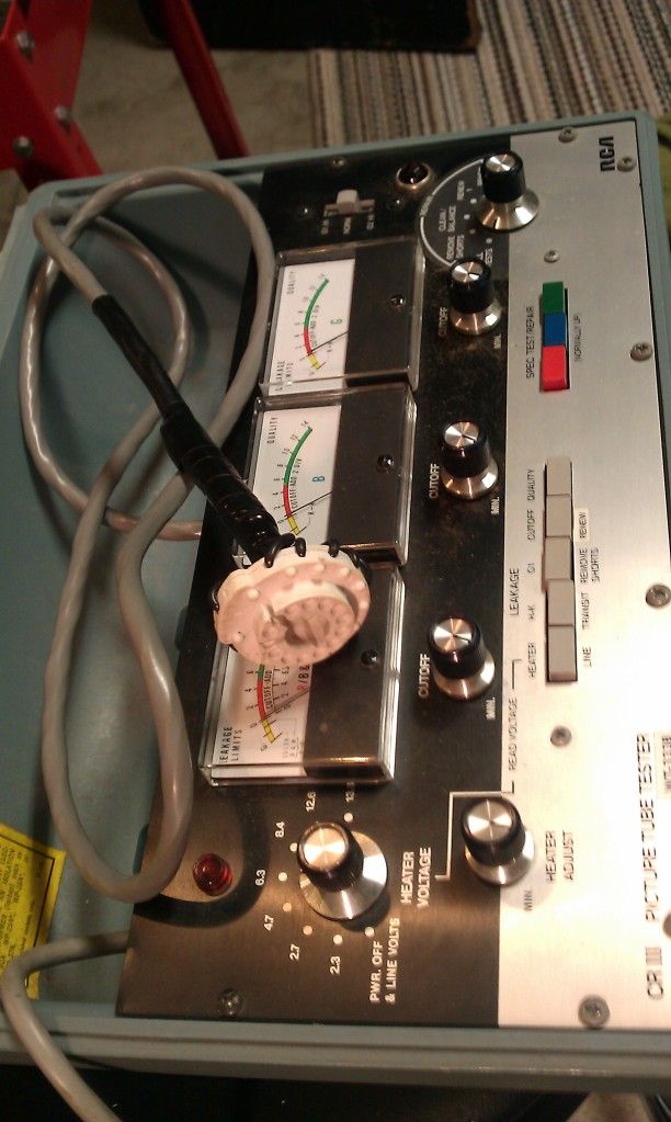

OK, so an old OP gave me his tube tester- rejuve. He stated he had B&Ks but really preferred this RCA model ( WT-333B), for whatever reason. Not a ton of info out there about it, but it does have the manual. Now, on to the issue.
Picked up a star wars with a possible tube issue and want to test it first to see if there are any shorts, havnt powerd it on yet.
Its an Ampliphone, but I have found mixed folks noting what tube model this is. The sticker on the tube is gone, embossing on glass is "19 V 90" noting a 90 deg tube I assume. The manual with this tester is vague and does not include tube models that are super common it appears, the standard harness on it appears correct but I cant find the model numbers of these in there ( I have the other sockets) , the following tubes are know compatibles with the amp I beleive

Is there another model I should look for? Or how do I decipher this tester and its manual?...
