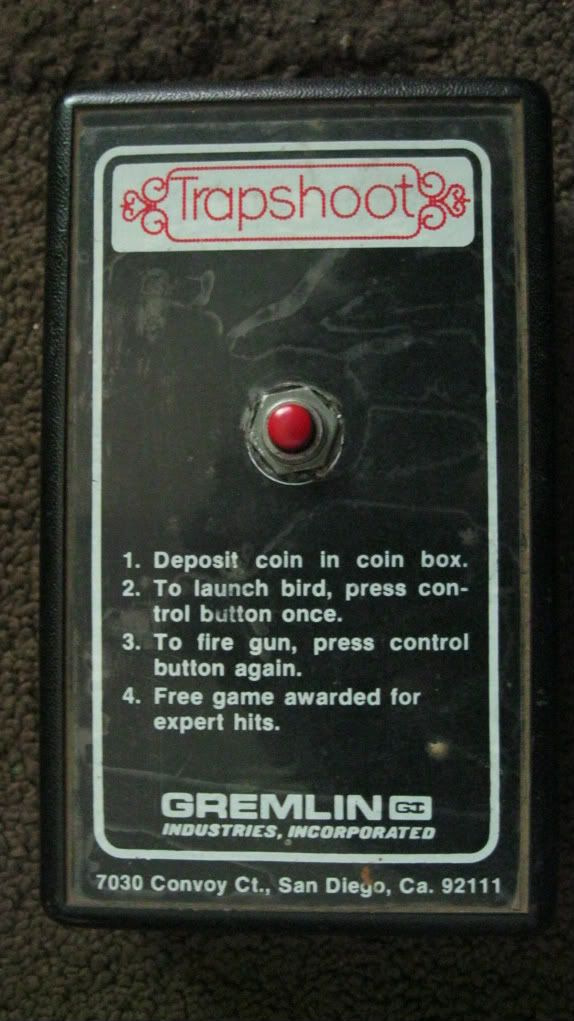

Here are a few preliminary pics of the Trapshoot. I have been documenting the parts I want to replace in order to rebuild the power supply(s) in the machine as well. If anyone wants the lists just send me a PM.
This main board, the largest PCB I have ever seen, measures 5' by 2' 7". The two sub boards plug into headers on this side of the main board while the other side consists mainly of light bulb housings soldered into place.
Yes those PCB's are large!! There was a guy that supplied new coin box and remote stickers a few years back.....I could do with some for mine.
Trapshoot for the Iphone...that would be fun!
Do you have any idea where he went? Did he advertise on a forum or sell through Ebay? I was thinking about having Rich repro the art but if someone else has already done it I see no sense in replicating work...

I am in for sticker replacements for the Gremlin game remotes and coin boxes.
