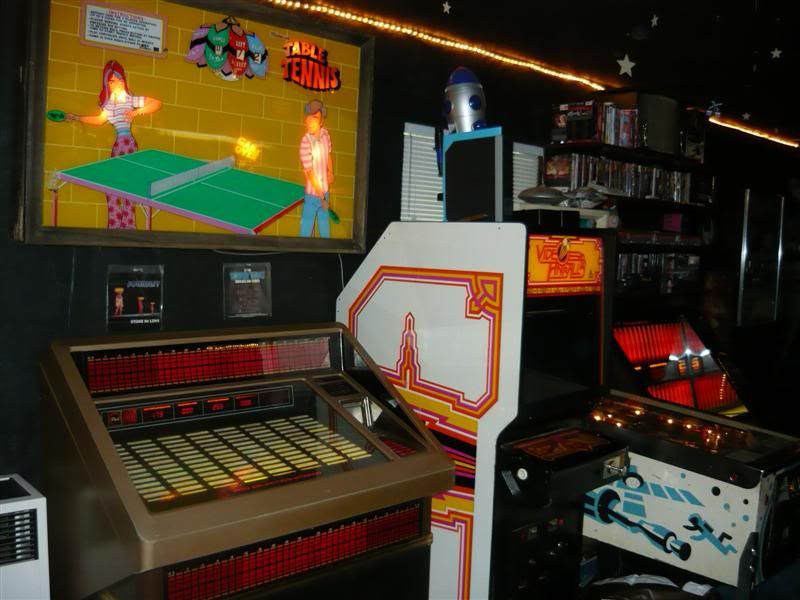

Here they are. I would love to figure out how to make them wireless.
Heh, very cool. Love the 70's attire! So what do the controls look like? Are they just single push buttons? 1 or 2 controllers?
Yeah... one per player, wired, single push button. You can see them, hanging on opposite sides of the game, in the pictures. Just pick one up, step back 5 - 10 feet, and play.
Well since there's two of them, a garage door opener remote like I have won't work since it only has one channel. You will need a 2-channel receiver of some sort along with a separate remote for each player. It should just be a matter of wiring and mounting the receiver somewhere inside the cabinet so that each channel is operated by one remote.
The receiver basically just works as an on/off switch so you should be able to wire it directly to where the existing switches connect. I would be careful not to hack any wires so you can put it all back to original if you want later.
One thing to be careful of first though is that you need to know if it's just a short momentary switch or if it needs the capability to be held down for longer periods of time. Some of the wall games need the later feature and it's a little harder to find remotes that can do that. Not sure if yours needs that or not.
