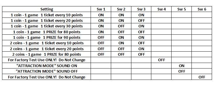

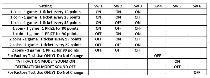

1playroom New member Joined Oct 1, 2009 Messages 12 Reaction score 0 Location Virginia Nov 22, 2009 #1 I Have a Wacky Gator game. Does anyone know What are the different position of the dip switches to change settings? I am trying to set it to take >50 cents per game. Please help! thanks

modessitt Volunteer: Encyclopedia Submission Moderator VAPS Joined Mar 22, 2007 Messages 33,414 Reaction score 325 Location Austin, Texas Nov 22, 2009 #3 Okay. Original Eprom Set First Alternative Eprom Set P/N: 965-0003-01 Second Alternative Eprom Set P/N: 965-0003-02
