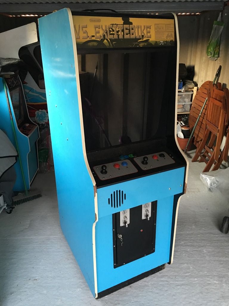

So this is the start of my first real arcade project. I bought two vs. Unisystems from Ken (fatsgt) with the intention to return one back to a Donkey Kong (my favourite and arguably the most iconic!). After taking delivery last week of the two cabinets, I was itching to begin (I've been sat on most of the DK parts for over a year now!).
So this was our starting point:

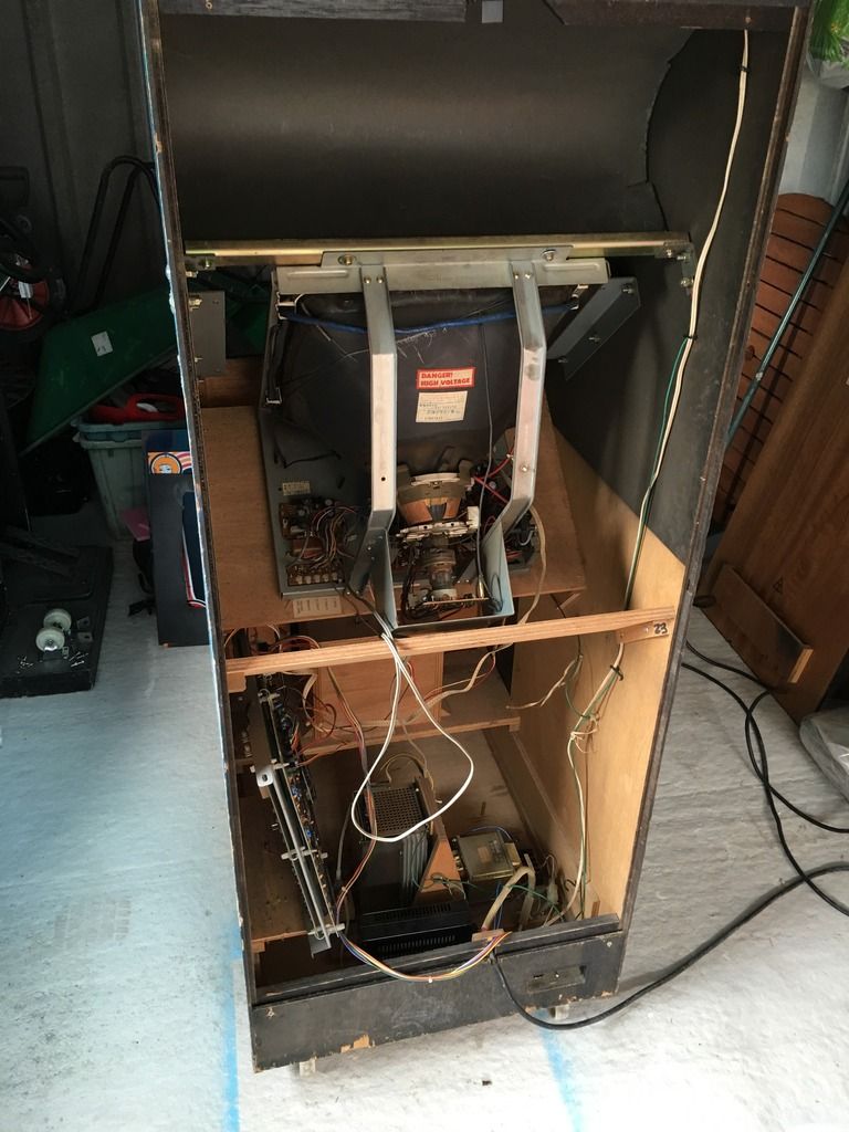

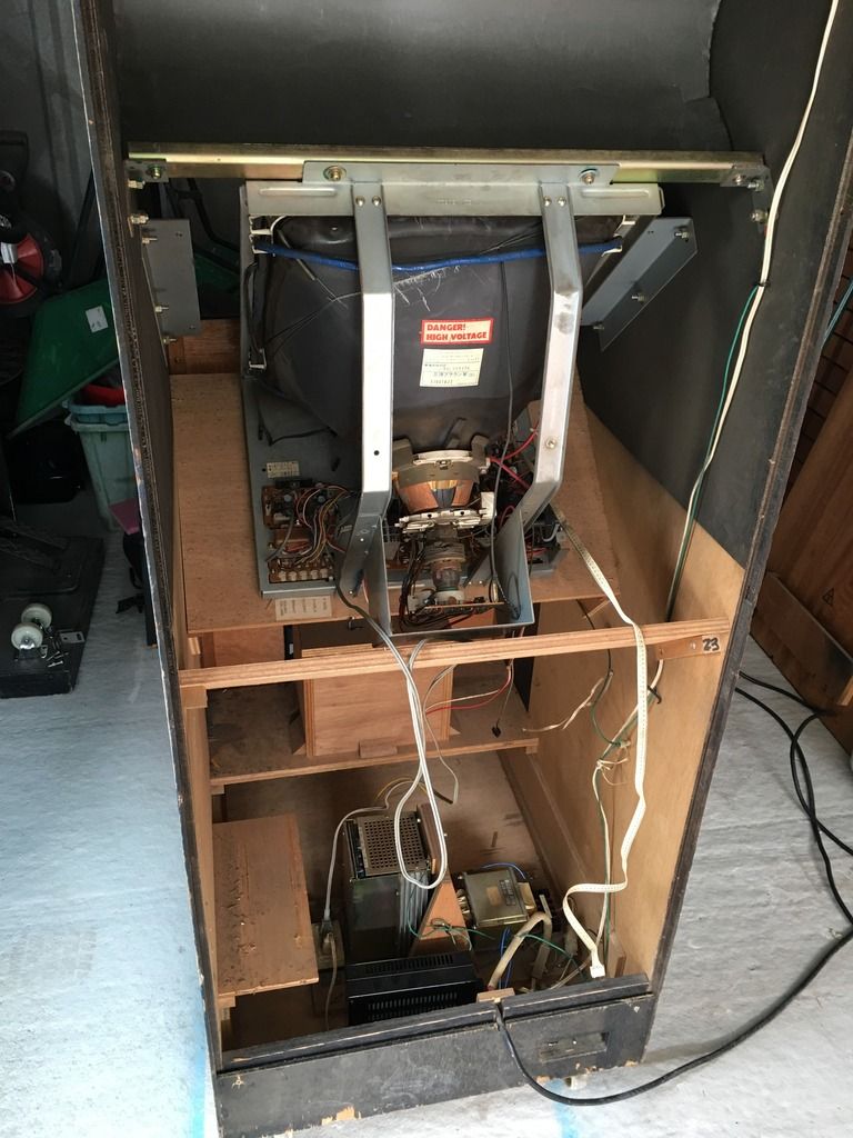

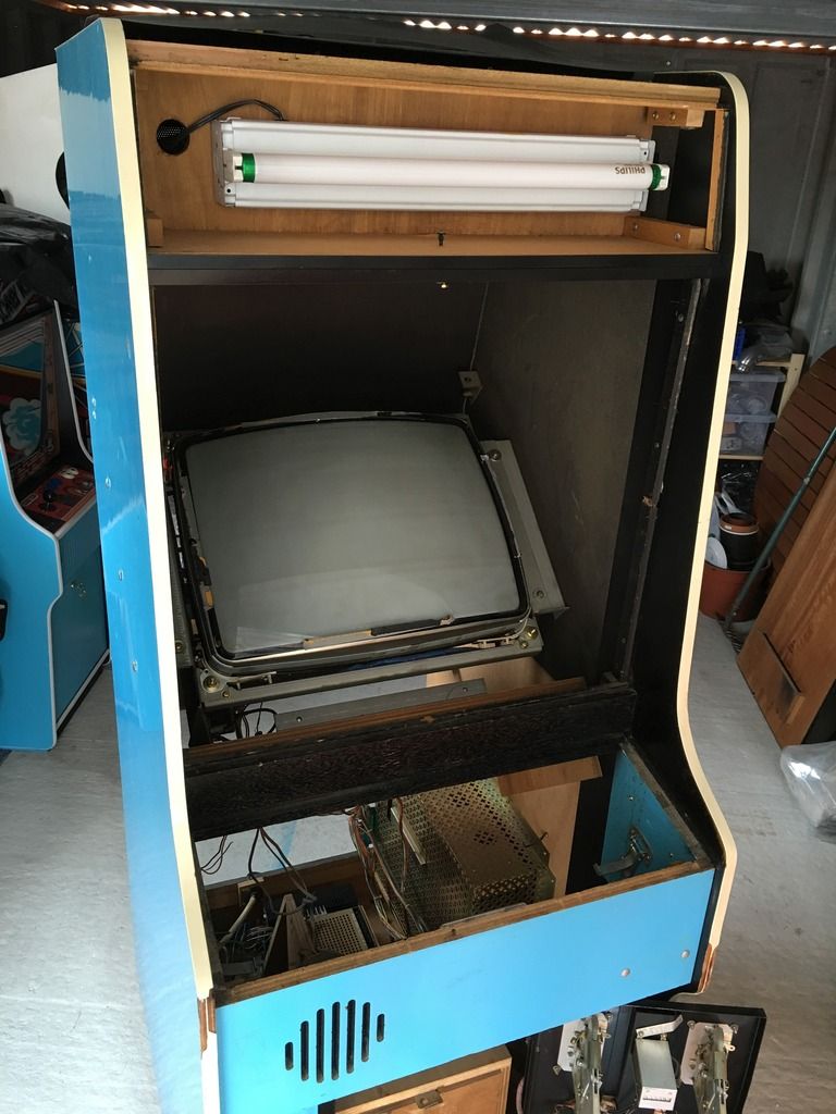

Excitebike will definitely being taking pride of place in my other Unisystem, but I'm afraid I need this cab for DK. I began by doing the part that frightening me the most... Swapping the orientation of the monitor. All bezel and marquee out, I began to strip out and unplug ready for the big pull:
At this point I realised what the bolts were in the coin door panel. I'd assumed they were for an old coin door brace, but turns out some nobber at some point has taken their anger out on the front "kick" panel:
That'll need fixing (either replacing the whole front or coaxing it back into shape with glue and clamps), but we're just doing a test fit/ dry run of DK first. So after a few nail biting moments with the monitor out, rotated and back in, I reconnected the control panel and fired her up (just to make sure I hadn't knackered anything in the process):

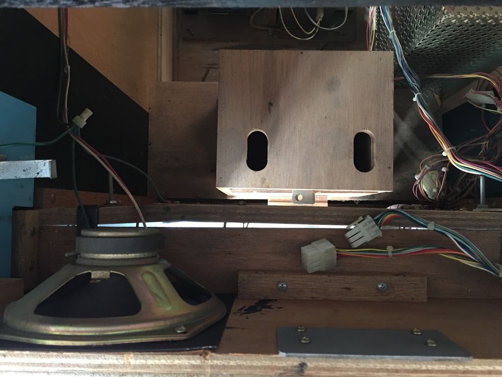

Cue no sound! Luckily, I'd just forgotten to reconnect the speaker (that'll do it!). Right, so let's start stripping out the Unisystem loom:

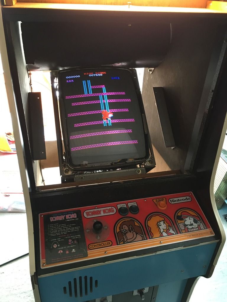

Loom out (luckily nothing bodged or broken), so I then put in my MikesArcade Double Donkey Kong and connected up using the DK loom I'd bought from KLOV last year:
Having never done anything with arcades before, this lead to a lot of head scratching and checking the manuals. As this is technically a DKJR board, the supplied rainbow cable negates the use of the 10P CLK cable. Adding to this, I'm assuming (haven't tried it) that the original PSU has blown at some point as there is a new switching power supply inside.
I have to admit, at this point I was expecting to flick the power and encounter either a snap, crackle or pop, but to my amazement, I was greeted with that beautiful start up song and this:

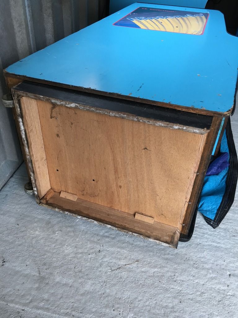

An emergency repair was also needed on the base of my other Unisystem as the front panel was off when it arrived and it then went from bad to worse:
A few (16!) headless nails later and the base is back strong again. I think I'll rebuild the base when I get to restoring this cab as the timber has seen better days

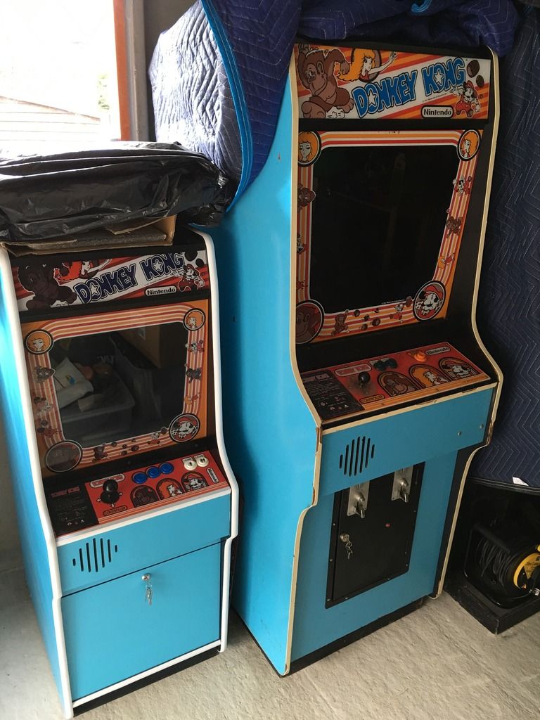

Aren't these originally DK or Popeye cabs that were converted to Vs cabs? I thought dedicated UniSystem cabs were gray and had the speaker under the marquee?
Yeah. It's pretty common to see DK and popeye's converted to something else. Mine was a RoboCop when I bought it.
Well here it is, fully back to a DK. Leaving it like this for a BBQ and some games this weekend with friends, but then I'm going to strip it out to start restoring the cab:
The mini DK next to it is my daughters. A guy in the UK builds them (currently has a 60in1 inside)

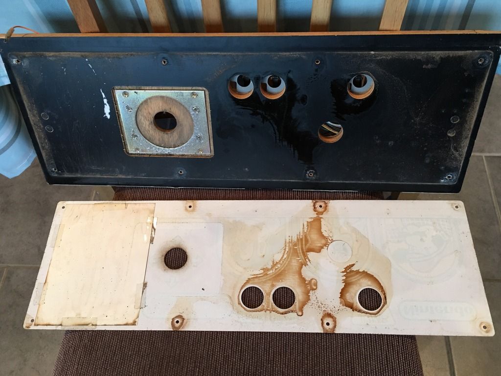

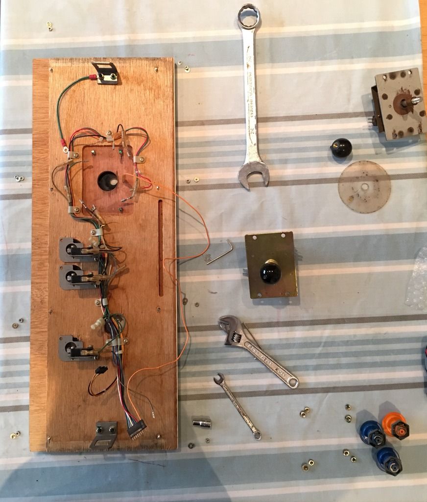

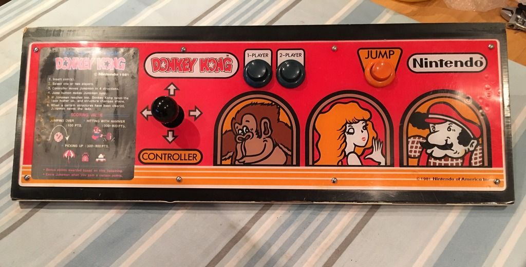

So the control panel tinkering was my job for this evening. The joystick that was in the CP wasn't particularly smooth anymore, but I had a replacement complete joystick from MikesArcade that I planned to use.

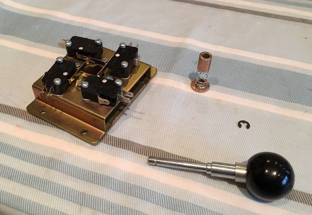

This turned out to be a complete strip down as I couldn't get parts of the old joystick to budge, so at one point I had got to this:
You can see the collection of tools I went through to get to this point! I also had to remove the CPO, and that was nice underneath
smiley11.gif" align="middle
(I'm assuming Coca Cola!) :
Then luckily I was on to the nice new shiny bits (my tool of choice for removing the C clip was a perfectly sized kitchen knife
smiley2.gif" align="middle
After a quick re-assemble (and clean), I had a complete control panel again:
The only issue I had was that the clear plastic circle that was supposed to sit above the CPO wouldn't fit. I don't know whether the joystick shaft is too short, but fitting it and assembling, completely compressed the joystick's spring. Something to look at another day...
