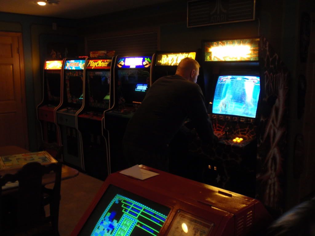

Oops, just realized that I caught my Tetris screen in a pic I took over the weekend. This was THE most played game by my wife, daughter and I over the weekend.
Glad to hear!! I was worried for a while there.
Nice color combo!
Thanks, I'll have to look and see which dip I have flipped. I only lose a bit of text in the title screen, but the game screen looks great. We also had the NES version going at the same time, man is that one a helluva lot easier!
