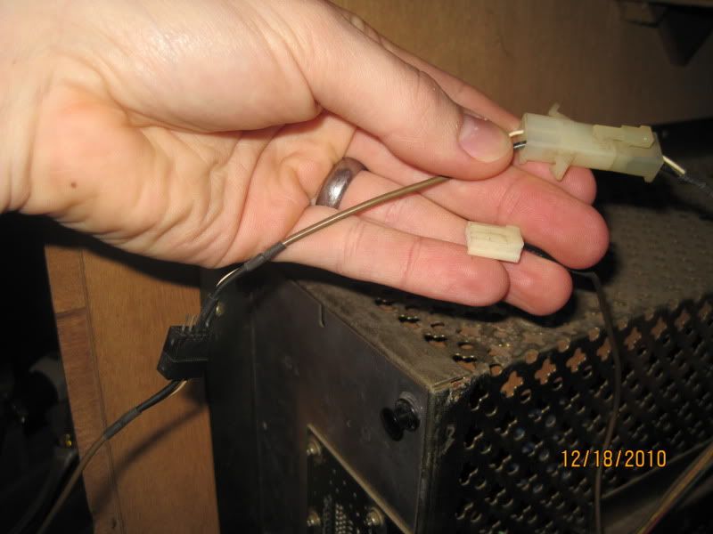

Finally got the camera back. Hopefully these 2 pics help.
first, the board itself,The arrow is pointing to the JA connector. I'm thinking the cord (in pic 2) attaches to it? The schematic doesn't show anything connecting though
the chord

I just picked up a VS. Super Mario Bros. cab, I'm going to start ripping it apart to clean it up and try to resto it as it works great but looks shabby imo.
I took a pic of that connection for you:
Looks like you have the right connection.
