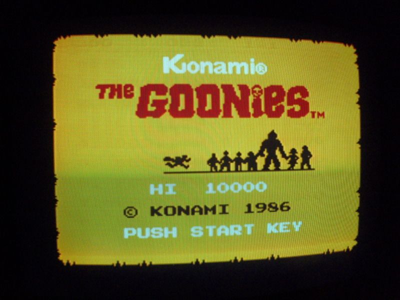

Hey guys. I'm trying to hookup a computer to my Vs. cabinet to run a "Multi-Vs." setup. The actual Vs. SMB hardware works fine. When I hookup the computer to the Sanyo, it looks like this...
...the Black and White appear to be reversed. It's not the computer or the VGA cable. It's gotta be something with the monitor. I hooked up a different monitor and the colors are fine, so it's something with the Sanyo.
Any ideas? Thanks.
if you are gonna run any other game/computer on a sanyo then you will need an inverter.
or you could toss a K7000 in there and be fine.
keep the sanyo for another nintendo cab.
try playing mario inverted it's wacky looking.
Peace
Buffett

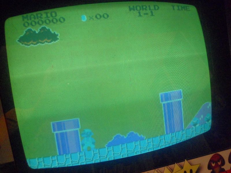

Makes sense. Here's what it looks like on my 13" k7000 test bench monitor...
So there's no way to change the Sanyo to accept regular video or anything else I can do? What type of inverter would I need. I have a 2 extra K7000s but they are for 25" tubes. I can use them on this 19" Sanyo tube?
Another reason I wanted to use the Sanyo is because it has the onboard sound amp and I wouldn't have to hack some computer speakers for sound. Everything is working great right now except for the inverted colors.

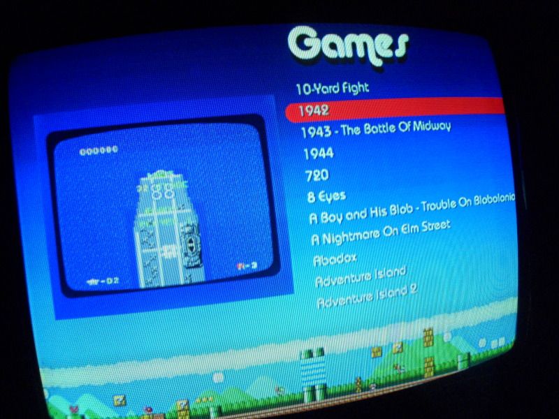

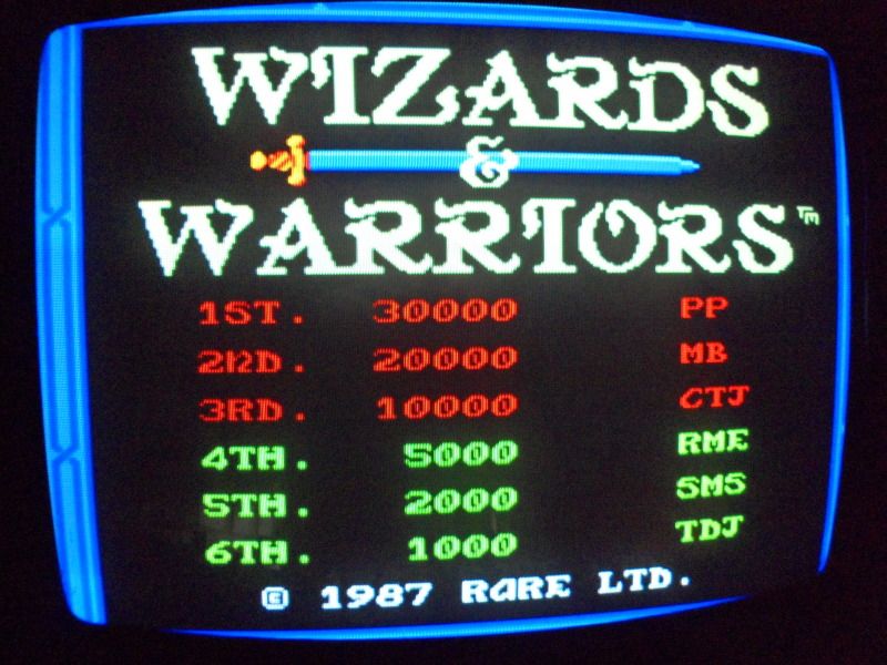

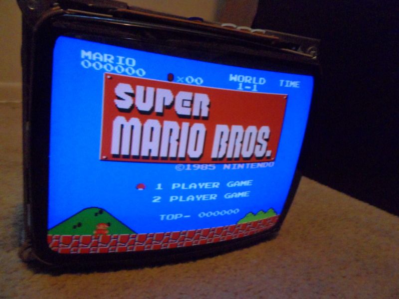

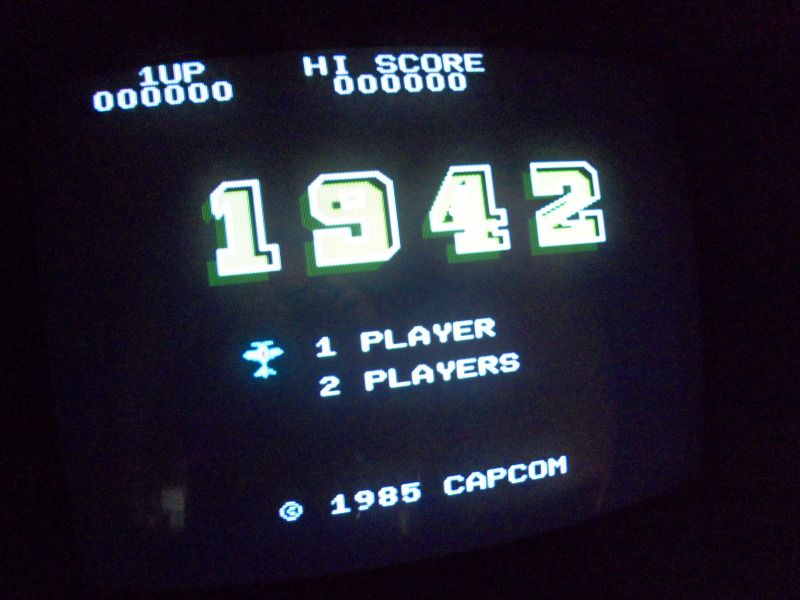

Thanks to the great Arcade Buffett, I received the inverter board and here's how it turned out...
Before...
After...
It turns out the inverter requires 12vdc and a ground to operate. I simply ran some wires from one of the computer's extra power supply connectors, adjusted the RGB, etc, and it looks amazing.
Again, many thanks to The Arcade Buffett for saving the day for me as I would have had to install a different monitor to complete this project. I will post a video later of this "Multi-Vs./Nintendo cabinet project. Stay tuned.
