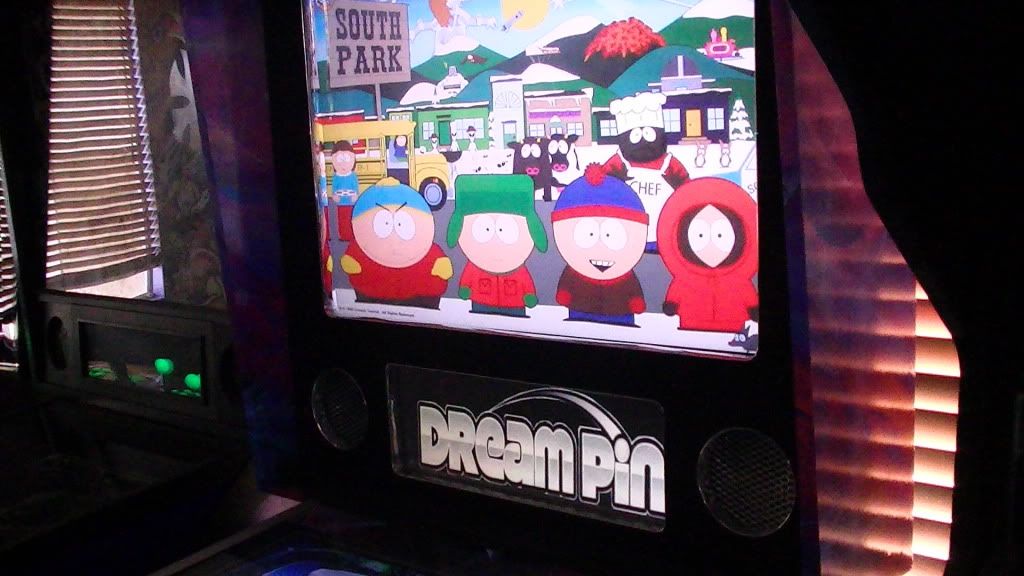

I redid the DMD area, and backglass. Took a photo. If anyone needs help building please feel free to ask.
H4CK3R
so is that one or two monitors for your backglass/DMD? It looks EPIC!
He has been helping me with my build (more pictures coming soon) and has been a great help!
There are two monitors in the backbox (one for the backglass and one for the DMD). The backglass monitor in his setup is a 32" monitor, I believe, and the DMD is a 19" monitor (mine is 30" & 17" repectively).

No doubt about that... My setup is 45"/30"/17" in a real cab... :D
Dude!!! That is awesome!!! I really cant believe how fun and real the whole thing feels. The guys who make the tables are doing a great job! How many tables do you have setup?
Right now, I have about 200 tables installed (but not all configured).
