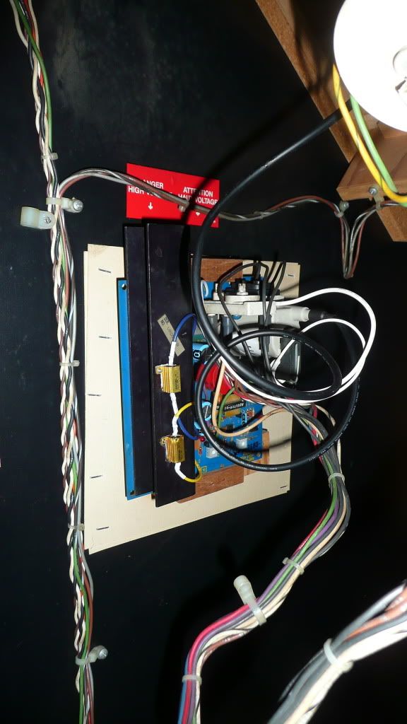

After running on an aftermarket HV board that Arcadeshop used to sell for the past 6-8 years, (i lost track of how long it's been) , i decided it was time to rebuild the original one that has been collecting dust in my garage. I read the Amplifone upgrade faq a few times and ordered all the parts from Bob Roberts. Teamed up with Dan ( Hatrick) and we copied Level 42's idea of the resistors mounted on the heat sink. I put in a new flyback and followed all the suggestions on the guide and now have a fully working HV board. The deflection board was working but had not really been touched. I did about 98% of the upgrades on it and have an incredibly stable picture now. Replacing the 10k pots on the deflection board made a HUGE difference in the stability of the picture. That was the last thing i did and saw a tremendous improvement with the new pots. Over all it was pretty easy and the only problem i had was when i first fired up the game and could not focus it. The lower focus wire ( not the one that comes from the flyback) had broken off and needed to be reattached. Once I did that I had a fully working HV board. What a difference !

I can get you a picture of the after market one. It will be my back up unit now. i don't think it was meant to work in a 6100, if i remember right they made a separate unit for that monitor.

We used the aluminum resistors exactly like the ones you used. I liked the idea of having them up on the heat sink far away from any other components. Thanks for the idea!
This is the aftermarket one. It will be my back up unit now. the heat sink that came on it was pretty ghetto from what i remember so we used the original heat sink :
This is the original one back in the game where it belongs :
