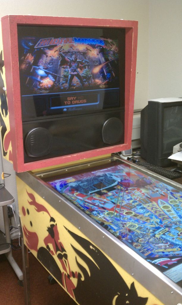

So what's your thoughts on Virtual Pinballs? I've seen a few places selling them, i've even done the cabinet for one. I know it's not the same as a real one, but i think they have thier place, kinda like the 60-1's. What's the cheapest anyone has seen one sell for? I'm talking a 42" lcd widebody type. I may be getting into these in the coming year
This was the first one i made. I wasn't happy with the way the head attached to the base. The 19" for the DMD was mounted in the lower cab, and stuck up into the head, no way to fold it up at all. Pretty sure there's a way to use a real DMD with virtual pinball, i'll be going that route on the next one. Probably TZ art on it too.
I think I might like to have one of these DP, what are you planning on using - Visual or Future? Doing a little research here.
My plan is Visual, i need to do a little more research myself! All the good tables modeled from real pins is in Visual. Lots of vids on youtube, search on there for visual pinball cabinet. Some really nice stuff out there. I hope to be able to afford to keep one at some point lol.
I took the one I built apart. Some games were good but many were not. Physics were off and lots of flipper lag or inconsistancy for many games. Its not the real thing and really suffers if beside the real thing. Still fun. A mean game of Flash Gordon or High Speed is not the same. STNG, Black Knight, and MM are all good though. Some of the Future Pinball games are also good like the custom Superman with video and the Star wars games. The analog plunger controller really was flakey too so just go with a button. Hyper pin did not seem stable exiting or entering games also. Ideally if you can pick a standard decased TV (where on button stays on), use a real pinball display size for score it should be decent. The current sellers are way over priced for a hobby pin.

So, what exactly is your issue? I'm one of the developers of HyperPin and admin of the HyperSpin/HyperPin website. Yes, the site requires registration as it's a community driven project and downloads are restricted to throttle downloads. Our supporting/donating members do not have any download restrictions as they are helping pay our $600 per month hosting.
As far as installing, HyperPin, Visual Pinball and PinMAME is fairly simple and straight forward. Install Visual Pinball, then install PinMAME and set the paths up correctly in the PinMAME setup. Once you have Visual Pinball and PinMAME installed and confirmed working then you can work on setting up HyperPin. Setting up HyperPin is basically unzipping it into a folder, open the settings.ini. This file is located in the Settings folder. Then edit the settings.ini in a text editor to setup your file paths for Visual Pinball. There really isn't much more to it... getting Visual Pinball and PinMAME working together is the main thing to focus on. Follow the tutorial for VP/VPM first, located here.
As far as digital pins... I'm an advocate for them. However, I know that a digital machine can NEVER beat a real machine. Unfortunately, people, like myself, are limited in funds or space or both. Since I am limited on space a digital machine made sense. I have access to over 200 machines at my fingertips, I can practice for tournament or use it to brush up on machine rules before playing the real machine.
