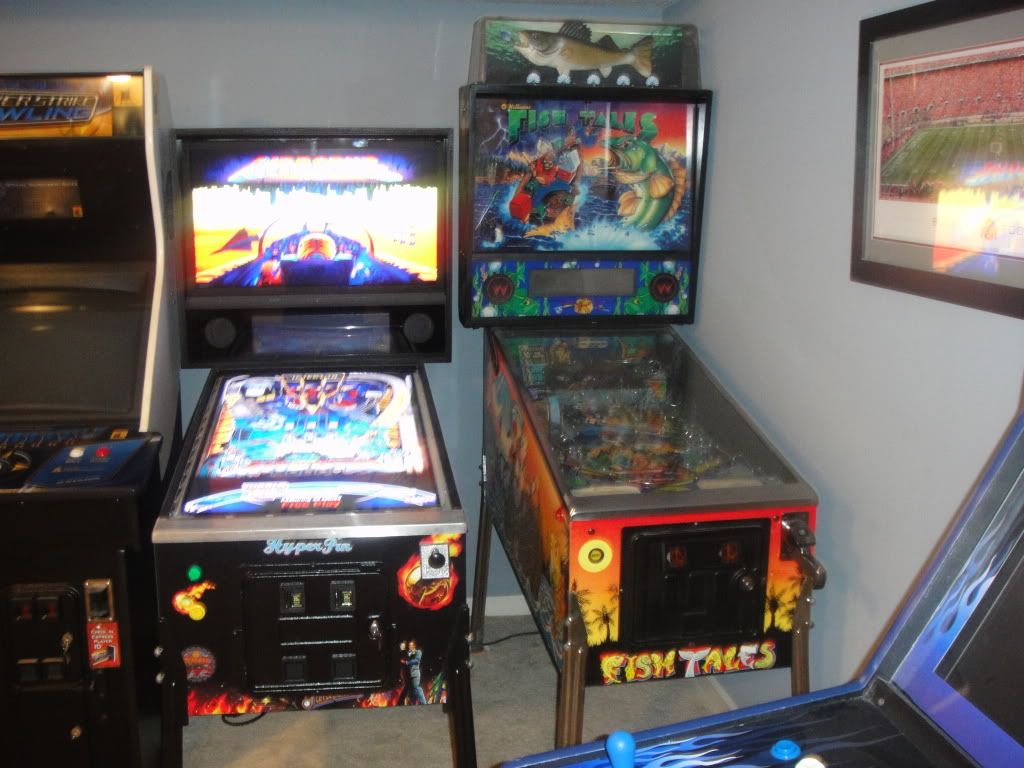

I took a look at my pin here (Fish Tales) and made some very minor adjustments, have bondoed the head and am ready for paint.
The guts are a Dual Core 2GHz Intel with 4 GB RAM, 80 GB SSHD and 2 NVidia cards, one 6800 and one GTS250. 42" Plasma Playfield is 1080p via HDMI and the backglass is VGA. (1024X768). I am still working on the computer set up but I had 25 tables working at last count. Had to buy a new video card for the DMD monitor as it would lose configuration after a reboot.

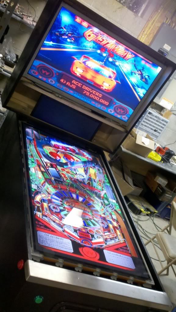

Here are a couple of videos... I will take some pictures as i am working on it for the NW Pinball show...
Circus Voltaire:
AFM:
Plunger:

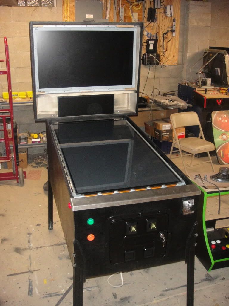

How did you trim out the edges of the playfield lcd if you dont mind me asking?
I can't seem to find any info on vpforums or hyperspin. my plasma has a 3/4" silver frame around it, do I just paint it black?
Also - how did you mount the 46"? DPTWiz (Brett) has this one set up to use a 3/4 rail on either side, but I am worried about potential for sagging. Should I put something in the middel to support it, via the VESA mounts?
You take the LCD out of the plastic. Then the metal edge is pretty thin.
The pictures above show I already did that. I am refering to (as I described) the 3/4" silver metal frame.
Ahhh, I guess you could cut a 1/2" groove on the left and right inside wall in the cabinet that the LCD could slide in which would leave only 1/4" left. That would require that narrow your cabinet 1 inch. The last 1/4" you could paint black, just mask the screen.
I have strips of wood that are sit on top of the edges of the screen (with double sided tape). they cover the metal perfectly... I then painted it black and routed it to allow me to mount the LEDs inside the wood:

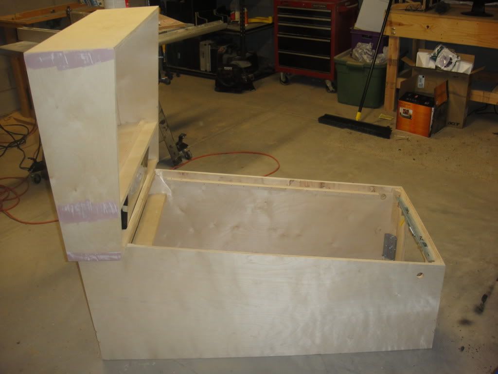

On the dolly for the trip into the shop
Bare cabinet assembled after some minor modifications
First mock-up after initial paint job

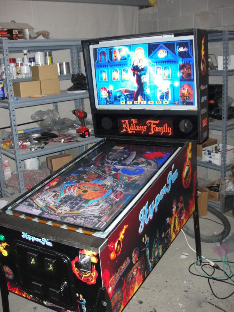

Mock up after decals applied
Final mock-up with original computer - Addam's Family was unplayable. :(
Current home after new computer - All 45 tables now play flawlessly! ($1200 later)

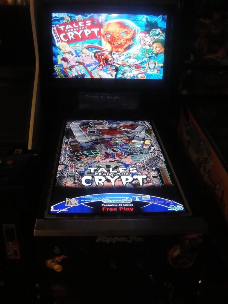

Tales from the crypt
All in all it turned out great. I learned a lot that I will translate into my next build. It still needs some trim pieces to be complete, but it plays and I am having too much fun to worry about it at the moment!
