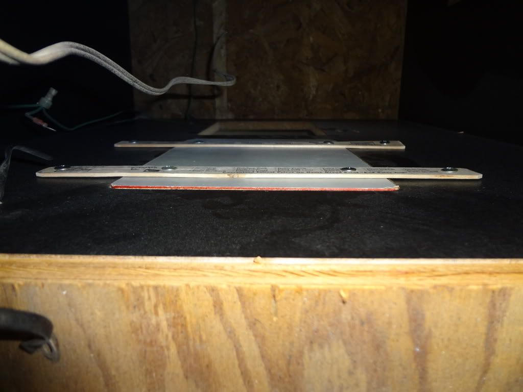

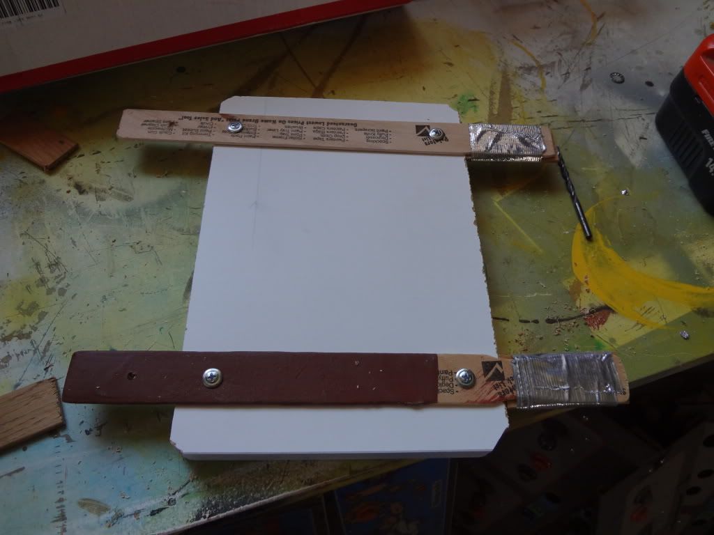

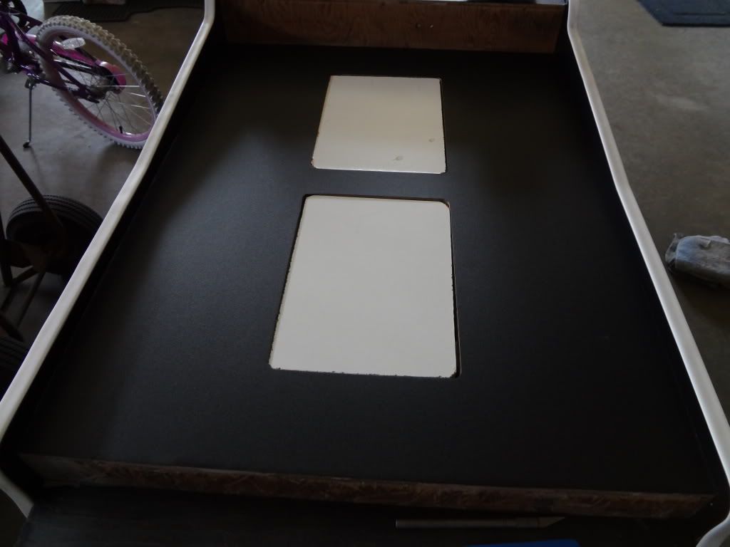

Made 2 plugs today and it worked pretty well. Cut them out, screwed slats to the back, secured them inside the cab with screws and laid the cab on its back.
Plugs:
Before vinyl:
After vinyling and trimming:
