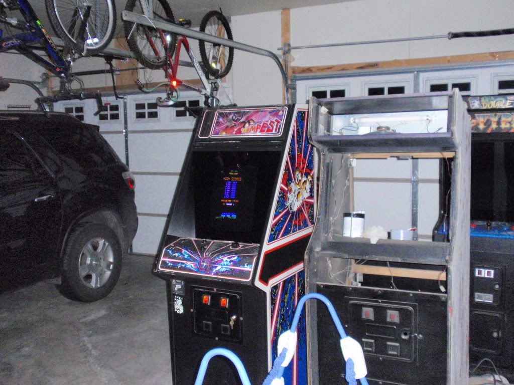

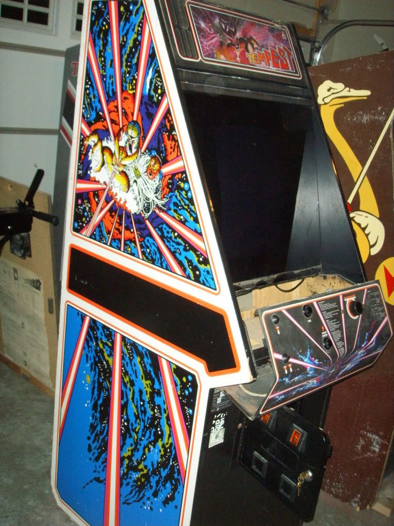

I had a line on one about 14 miles from me a little over 3 years ago. Dude wanted $450, and the top of the cab looked like it had been attacked by a Great White Shark. When he went to turn the machine on, nothing happened. He tried and tried, but nothing. He said sorry, I'll see if I can fix it. 3 days later he calls me, but I just didn't feel confident in the machine, so I passed. I have been mildly seeking a decent one ever since. About a month ago, I started to get more active about it. 2 weeks ago, I saw one on MPLS CL for 2 bills, but after contacting the seller, found out that I was the 2nd in line. Unbeknownst to me, 1st in line was an acquaintance of mine and fellow KLOVer, Jeff Klam. He contacted me after he picked it up as he saw I was interested in it. We agreed on a price and I picked it up with my lovely wife yesterday. Serial # 11762. Monitor looks awesome, cab is in great shape, though the marquee is trashed on the top. Game is clean inside and out, this one will just get a sanitizing, a new spinner knob, a new marquee overlay and 2 new Pokeys to fix the spinner and plyr 1/plyr 2 issues. I assume I should rebuild the ARII and the 6100, but for now, I'm gonna just clean it up and enjoy it. I'm pretty stoked:

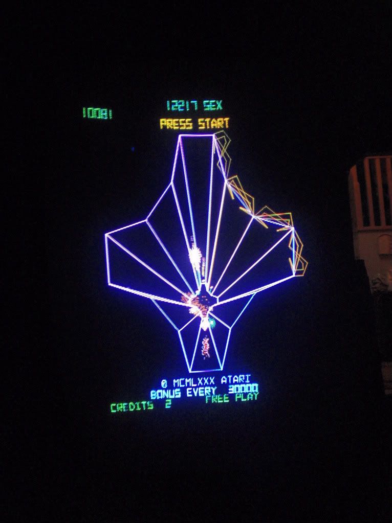

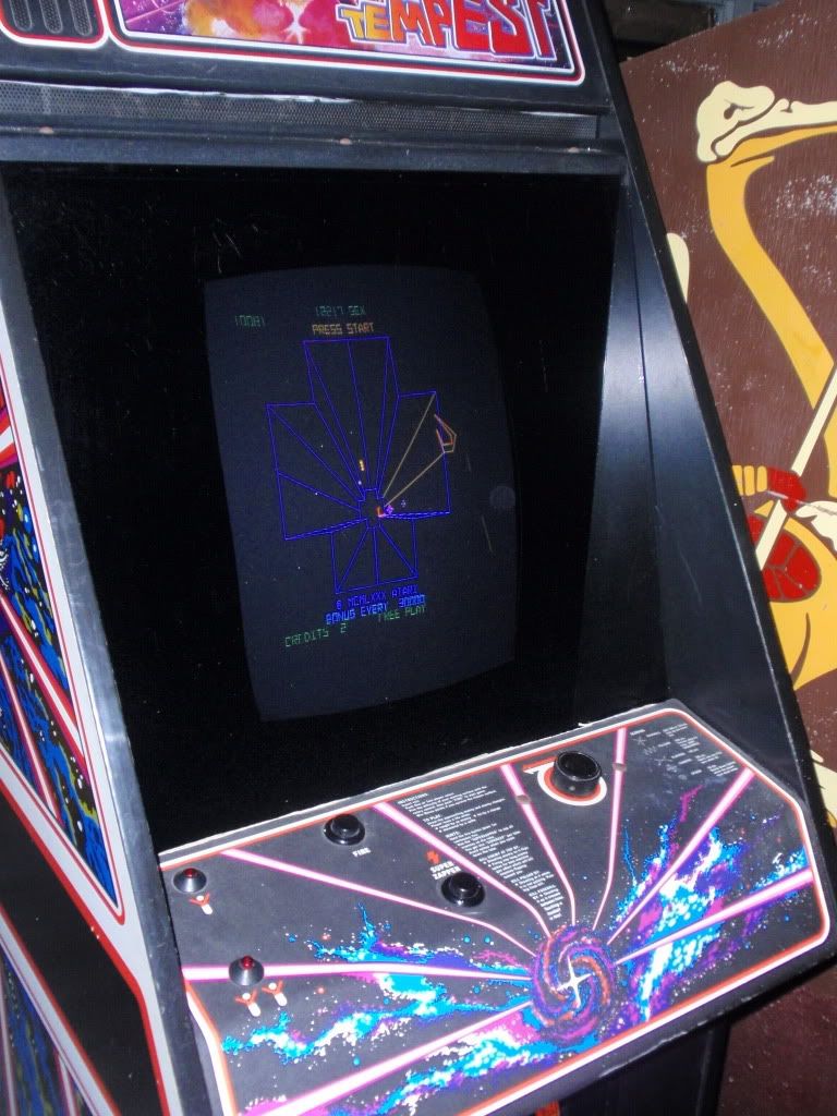

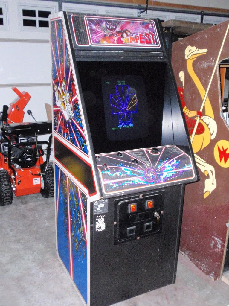

It was the 2 pokeys. Replaced them tonight, and had 1 &2 player start and full control of the spinner. I cleaned up the bezel, cleaned the glass, monitor and CPO, washed the inside a bit, put new adhesive foam onto the bottom of the glass to cushion the cp, and put up my first high score. This game is so much fun.
Comments:

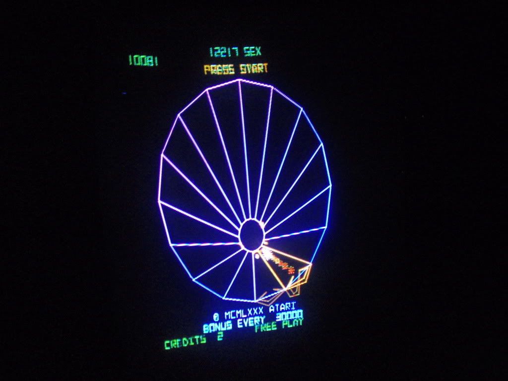

1) In one pic it looks like GAME OVER and PRESS START are overlapped, but that might be an alternating image that got captured in mid-change by the camera. if not, you need to adjust your pots on the game board to give yourself some separation there.
2) "SEX" - really? Why am I not surprised?
3) You need to quit taking your camera to the truck stop. Too much splatter on the lenses.
4) Okay, looks good, now pretty that cab up! Get that tax sticker residue off. Is the marquee light working? You need one of those Atari pricing stickers on the coin door. Both mine have them and they look great...
