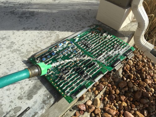

Just out of curiosity:
I know it's a widely held bit of wisdom that one should never use a Shop-Vac with a dusting attachment to clean a PCB, because there is a risk of a static discharge causing all kinds of death and destruction.
It is also a widely held bit of wisdom that one should never use water to clean a PCB, because the tiny little bits of mineral (unless we're talking about distilled water) could be conductive, and thus cause a short, again causing all kinds of death and destruction.
My own experience, as well as that of those who I think of as legitimate experts in the field find the point about water to be such a low risk as to be safely ignored (assuming the PCB is properly dried).
On the other hand, I have very little experience or information on the vacuum thing.
Has anyone ever actually seen a PCB destroyed by a static discharge from a vacuum cleaner?
I ask because I recently invested in a small Shop Vac with the teeny attachment set for use in cleaning pinball playfields. It sure looks like it would be a great way to get rid of the loose stuff on dirty PCBs, and to keep them from crusting over in the first place.
If the collected wisdom here says it's a real risk, then I won't do it. On the other hand, if this is another "Old wives' tale", it would sure be a nice way to keep a board clean without even the need to remove it.

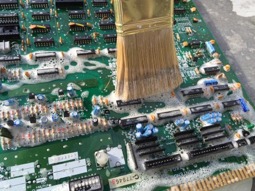

I've washed a couple PCBs by scrubbing the board with simple green and a paint brush. Then hosed it it off with good 'ol fashioned garden hose water. (make sure you leave your kids' water balloon tip on the hose end :) )Just have to remove any socketed chips and let the board dry before using it again. No issues thus far. #fearless
Heck some people throw them in their dishwasher...
Couldn't advise you with the vacuume. But with some of the PCBs I have cleaned, a vacuum would have never got the board clean.
I wash all boards I refurb, similar to above, with Greased Lightning and a paintbrush.
I also will vacuum off boards that are dusty from sitting (i.e., ones that have already been washed, but have been sitting around for a while). I use my Dyson, with the brush attachment.
I've done it to literally hundreds of boards, without a single issue.
I've had great luck with the "Wet method" as well, which is why I pointed out that despite being well-accepted, the concerns are generally unfounded.

I always clean boards with Simple Green, a paint brush and water. I suspect the mineral deposit argument is more likely with newer electronics with much finer pitch components.
