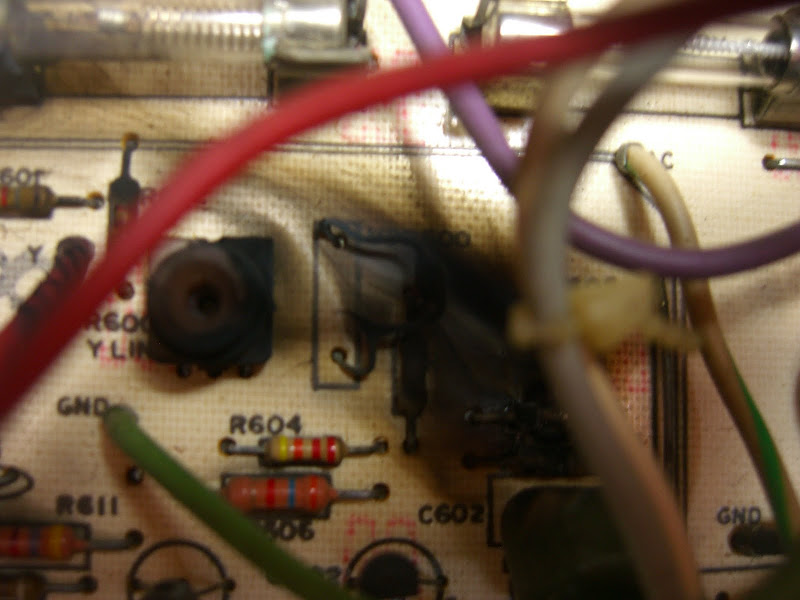

I'm on working on an Omega Race with a v2000. I've just put the monitor back together including a new HV diode as described here. The game boards themselves are a work in progress, but I got them to the point where I could tell the attract mode was running without the monitor plugged in. I installed the monitor in the game and powered it up. The Omega Race attract mode was displayed. However, the Omega Race test mode would not display, it was just a series of scrolling diagonal lines. Back to normal mode, attract mode shows up fine... for a few minutes. After a few minutes the screen went blank, with a few random flashes here and there. Every now and then it would start to display the attract mode, and then flake out again.
I suspected the game boards even though I could tell the program was running. That is until something blew up in the monitor. I quickly turned off the power, and this is what the deflection board looks like now:
So my question is, what could have caused this failure? Is it possible the output from the game boards themselves could have caused this? Thanks for any help...
So I installed an extra deflection board I have, and the exact same thing happened. Resistor R613 started smoking so I quickly turned it off. Is it possible that I've messed something up in the HV assembly when I replaced the HV diode?

This seems to describe my problem exactly. It seems very unlikely that both my boards would have the exact same problem. To me that points to a problem external to the board... right? I'm going to replace the frame-mounted transistors and all the burnt components and see what happens. Unless anyone has any other suggestions?
Well I've replaced a number of components and the deflection board no longer catches on fire. Unfortunately I have no picture. The heater is glowing, I can hear vector chatter, the spot killer is not on, no fuses are blown. I can feel static on the front of the monitor. The brightness and contrast controls do nothing.
What should I do next?
