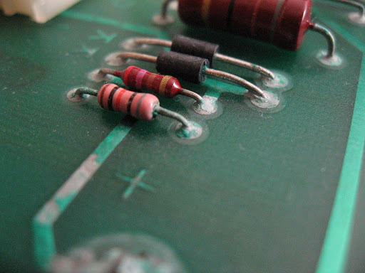

Just a follow up... my USB scope came today (the proverbial slow boat from china!)..
anyway, its very cool IMO.. Here are a couple of pics... one from the scope and one from the macro setting on my camera for comparison.
the microscope has a manual focus wheel, so I could probably have gotten the focus a little sharper, but you get the idea.
Scope
camera

Can you change the magnification? There may be times I want something enlarged, but I don't need to examine it on a sub-atomic level...
You can't change mag per-se, but it has a pretty wide focus range. It will focus from right on top of the board to about 3" out. At the farthest out, one key on my KB pretty much fills the image. All the way in is about 4x that.
Omega Race PCB?
Close... MCR power supply!
Maybe I should start a game... ID the board from "EXTREME CLOSE UP" :D
