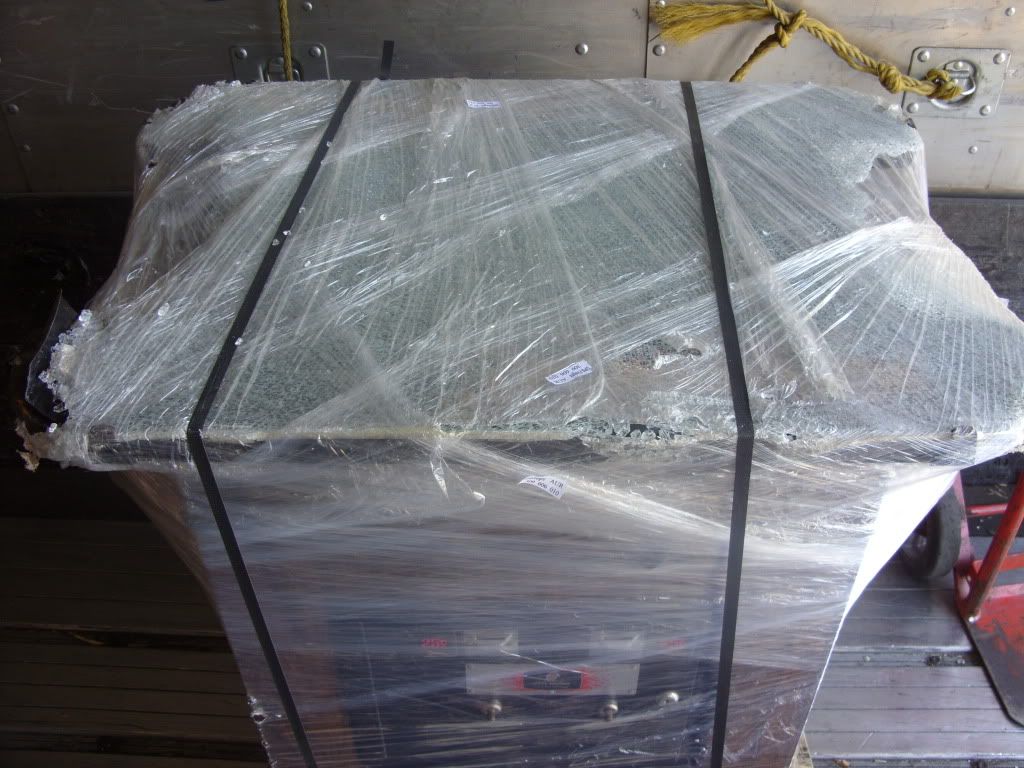

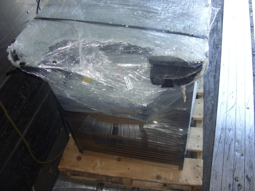

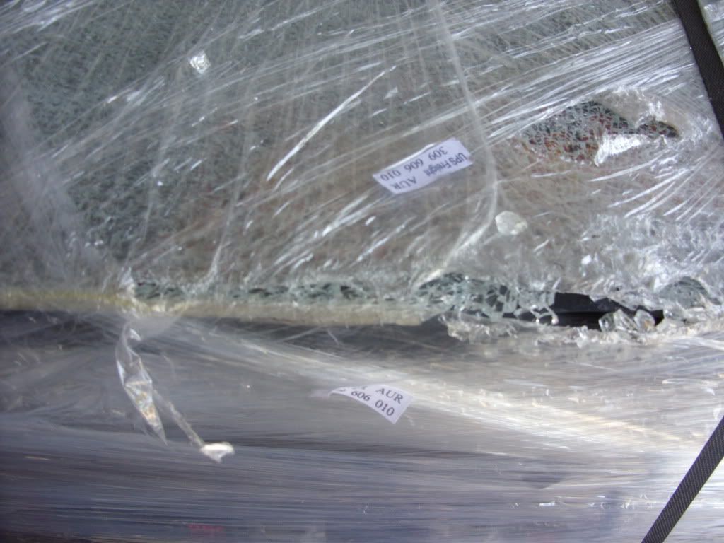

2 Months ago my Satans hollow was Damaged by UPS Freight. they hit the top corner with a fork lift damaging the wood and destroying the glass, They damaged one coner of the underlay bad!! That will be hard to replace, any other damage was hidden under the broken glass. It went back to there local Warehouse. and the Claims process began. 2 months later they called me and said all the insurance would cover is .10 cents per pound. They told me they if I did not accept delivery and pay there delivery charge, they were going to ship my property off to auction. The old hag that called me was a rude bitch!!!

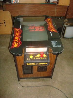

So the truck came a few hours ago. Spend an hour cleaning up glass. Ok cleaned up, Time to see if it works, Turned it on nothing from the monitor. played blind. Checked all connections again. Got the Monitor to come on but but its bouncing. next time I turned it on Nothing again. Now its bouncing again???

here are a few pics.
I think I mentioned it before when you posted these pics, but whoever packed it like that was asking for it to be damaged. The pallet needs to be bigger than the cab, and the edges need to be padded. Might not stop someone from smacking it with a forklift, but a bigger pallet keeps the forklift farther away, and padding can help absorb the blow.
If the shipper insured it, then it should be covered. If not, then you may be SOL...
As an experienced shipping loader, I can say from the pics that no amount of padding would have helped, or pallet size. Either someone was driving with forks not lowered or they were stacking on it and didn't angle properly when unstacking.
If those are photos of how it actually shipped, yeah you're SOL for sure. Technically, that probably wasn't packed to UPS shipping specifications but freight is a bit different than ground and that looks bigger than 108" inches total limit of ground. There's nothing to protect the exposed edges and corners, not to mention glass. Probably should've been crated.:001_ssad:
that packing is bad. should wrap in shrinkwrap first, then in full cardboard, then shrinkwrap again. for games with glass tops, a pillow or couch cushion should be added to the top. "fragile" glass stickers should be place on top and "do not stack or shelf pallet" should be on the game and on the BOL. also, "no forklift" stickers on eahc side of the game packing (hand pallet jack only).
pallet should be larger than the game all the way around and 2 heavy duty wratchet straps should be used.
not cheap metal bands!!!
Agreed.
Sorry this happened to you but freight shippers do not look at this as a collectible game, they look at it as freight. The faster freight moves, the more money they make. Plan for the worst case scenario and over pack the shipment. Stretch plastic and a layer of bubble wrap is not enough.

This was inadequately packed. And I know from talking to a forklift operator that if they see something like that, the see an open invitation to see how badly they can damage it. It's fun - a game for them.
It's not nearly as fun to mistreat a completely crated or boxed item because you can't see the damage you're doing.

Well Im not sure on the packing. I ran a forklift for many years. the chunk of wood that was taken out by that fork inpact tells me it was hit hard, and would have still broken it in my mind. The driver made some comments about they way it was packaged, but with the force of this impact?? I dont ship machines, this was the first ever that I had shipped so I really dont know. The packing could have been better, but I still think it would have been damaged.

I looked at the Machine last night. Monitor has serious issues, plack plexi cover monitor was all scratched up from the glass, underlay is screwed up. and the speakers were having issues too. Its a mess:mad::mad:

no way would I have sent that game out dressed like that. not in a million years. earlier comments about dock workers looking at it as a challenge to see how bad they can jack it up are true. sorry for the long read, but it's an area I have been in the better part of my life.

I do not know who you got the game from, but I would be
more upset with them than UPS for doing such a crappy
job of getting that game ready to go for shipment.
1.) Pallet is too small
2.) Not enough protection around edge of glass
I can't even believe that UPS allowed that thing to be loaded
on the truck like that.
To do the job right, I would have put the game on a larger
pallet and went down to the lumberyard and bought some
OSB board and built a crate around the game., 20.00 or
30.00 in materials is cheap insurance. Tempered glass
doesn't take too much of a beating when the edges are
exposed like that.
be happy you get $30. Seller, If your going to ship something and you take the time to find 1 pallet, find 2 more and use them to build a crate. Then make a false top so they won't put anything on top of it.
Sad to hear it got destroyed. not likely you will find replacement parts.
I would say its the sellers fault, but as a buyer, you should make sure your game is properly packed. If your going to spend $200+ to ship a game throw another $40 at the seller so he can buy some 2x4's and build a frame and use some ratchet straps to secure it to the pallet.
