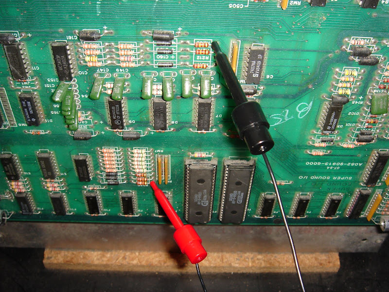

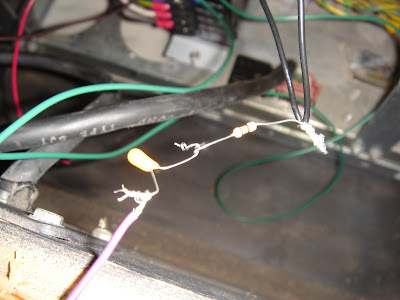

The needed resistor and cap between the sound out from S&T and the sound-on points on the SSIO:
The sound jump-on points on the DOT SSIO board:

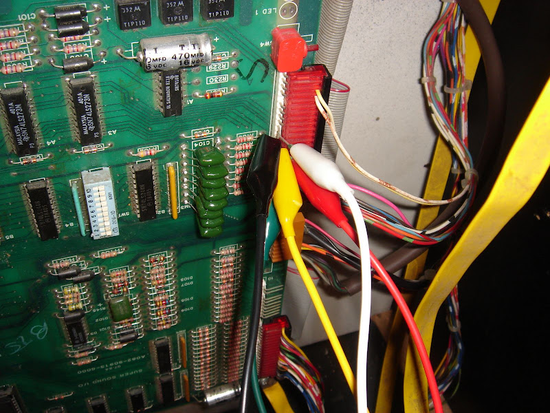

The game interface jumping on points on the SSIO board (I've since bent the pins correctly and made a molex connector) - The big green caps on the SSIO board were missing from mine, and are needed for speech.

** Jump pins 8 & 9 on J5 on the SSIO board to put the game in Speech mode.
** Connector J1 on the Squawk and Talk board: From S&T-J1 to SSIO-J5: Pin1(blue) to Pin10 / Pin2(orange) to Pin11 / Pin3(yellow) to Pin12 / Pin4(white) to Pin13 / Pin8(grey) to Pin14. On the S&T board, J1, Pin5(red) goes to +5v on the switching PS. Pin6(green) goes to ground. Pin9(brown) goes to -5v on the PS. Pin14(green) goes to ground.
** Connector J2 on the Squawk and Talk board: Pin4(white) goes to a 5k ohm pot for volume. Pin5(yellow) goes to the pot. Pin9(purple) goes to the end of a 13K 1/4w resistor, which goes to a 1.0UF 50V 20% CER RADIAL capacitor. The two black wires connected to the other end of the capacitor go to the two test clips to the right. Pin10(green) goes to to ground.
