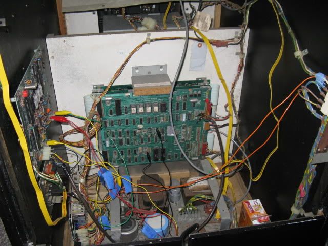

In the end, you'll have a mess that looks like this:

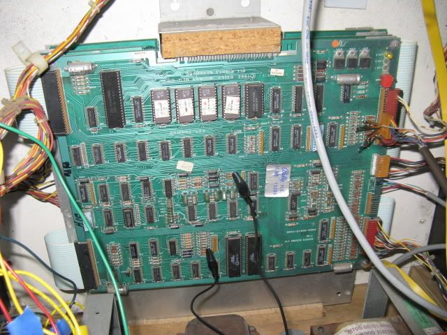

SSIO:

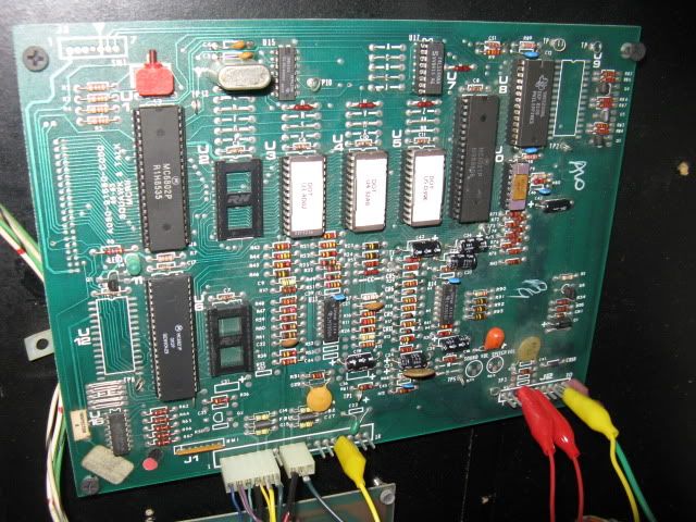

Squawk & Talk:
Before you do anything, make a list of all of your connections and assign them to your colored wires and label them. My list looked like this:
On the SSIO board, you're connecting everything to that group of pins labeled J5. On the S&T board, you will be using the J1 and J2 groups of pins. I removed my red connector from the SSIO board and carefully bent the necessary pins straight out, using needle nose pliers, so that I could slide the connector back on and still have access to the pins. Counting up from the bottom pin, I bent out pins number 8, 9, 10, 11, 12, 13, and 14.

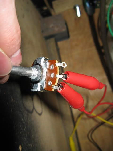

11. J2-4 to 5k Ohm pot (controls volume)-see pic below
12. J2-5 to 5k Ohm pot (other connector)-see pic below

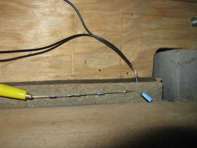

13. J2-9 to 13K 1/4w resistor which is connected on the negative end to the 1.0UF 50V 20% ceramic radial cap (don't know if it's supposed to be the negative side, but it works for mine)-see pic below
14. Positive (?) end of cap not connected to resistor gets connected to the side of second resistor below (or above, depending on how it's mounted) the label R220-see pic below
15. Another wire from that same positive (?) end of the cap to the side of second resistor below (or above, depending on mounting) the label R212-see pic below

So that's about 16 wires give or take. You basically just need to connect everything up. I attached all of my grounds to the ones on my switcher. The S&T board connections are pretty easy because there's nothing else to connect there, so you can alternate bending the pins up and down so your alligator clips don't touch. However the SSIO connections can get pretty cramped. Here are 3 pics of how different people did it.
Mine:
JeffC's:
caker137(?) from ionpool tutorial:
The one in the ionpool tutorial is the neatest with a custom adapter, JeffC used a bunch of alligator clips (I think he's since cleaned it up), and I used some alligator clips and part of an old wiring harness from my Tron. It doesn't matter how you do it…you just need to make all of the connections.

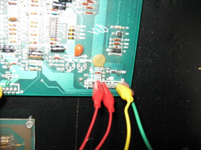

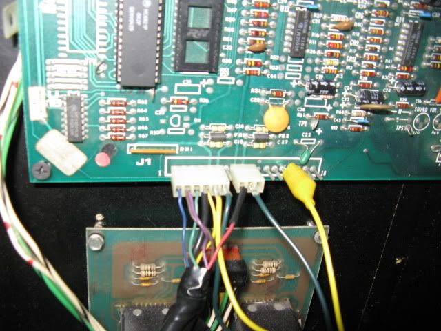

Here are pics of my J1 and J2 pins from my S&T board:
In my pic, DO NOT study any of my wiring colors closely, as I used what I had available and in one case, spliced 2 different colored wires together to get enough length. Those 2 ugly alligator clips on the SSIO board that don't seem to be connected to anything are actually clamping down two wires to the pins…talk about lazy! I should really clean up all of my connections, but it currently works, so I really don't feel like messing with it.
5k ohm pot:
My 2 resistors and cap soldered together and attached to the wires that connect to the jump points on the SSIO:

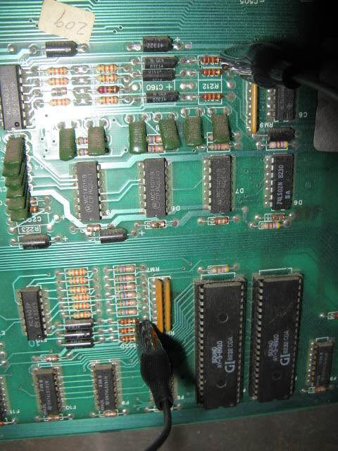

And here are the 2 jump points on mine:
And here they are on JeffC's:

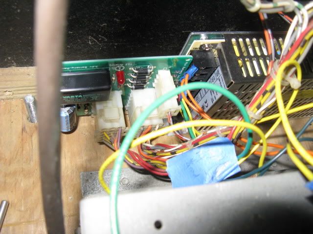

Here's a pic of my switcher and adapter, for what it's worth:
Again, a lot of people want to keep the original power supply, and I was going to try to do it. However, I had several burnt connectors, needed to swap out the battery, and still needed a switcher to power the S&T board, so I just decided to run it all off the switcher.
If all goes well, you should be getting +5V at the test points of your S&T board, it should have a lit LED (mine's green), and if you push the red button, it should cycle through the sounds. If you put your game in test mode, it should also now list "voices" and also "lights" because your DOT now thinks it's an EDOT, and as such, the 2nd player button will no longer work (because EDOT doesn't have one). I guess there are hacks to correct that, but I'm not going to bother with it.

Then attach + of the cap goes to SSIO R220 (separate lines for stereo sound)
9 - Wire to a 13k resistor (12k followed by 1k is fine) then to Neg of a 1uf 50v cap.
Then attach + of the cap goes to SSIO R209 (separate lines for stereo sound)
