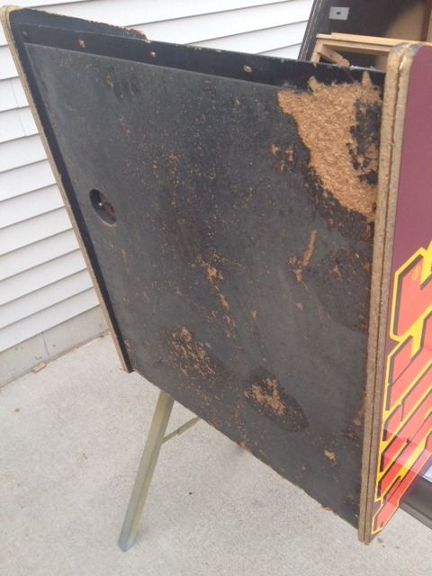

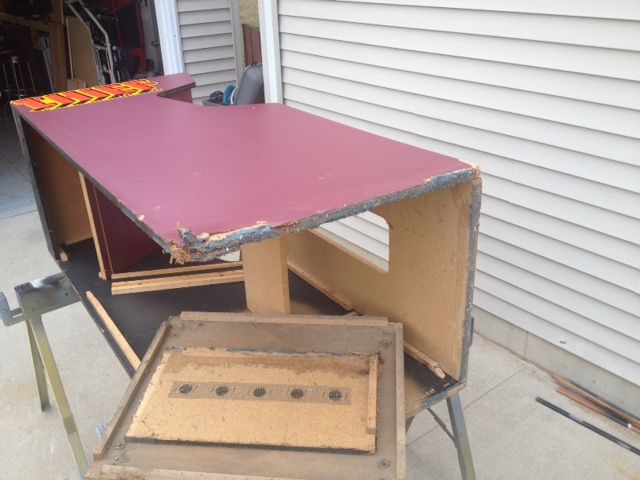

W as looking for a Thief for a while and the only one that could find semi locally (I drove 6 hours each way to Ohio last March) had a bad cabinet and the internals in boxes. I was sick of looking for one so I bought the project.
Bottom was caving into the cabinet due to the water damage to the bottom
Top was flaking really bad due to water damage

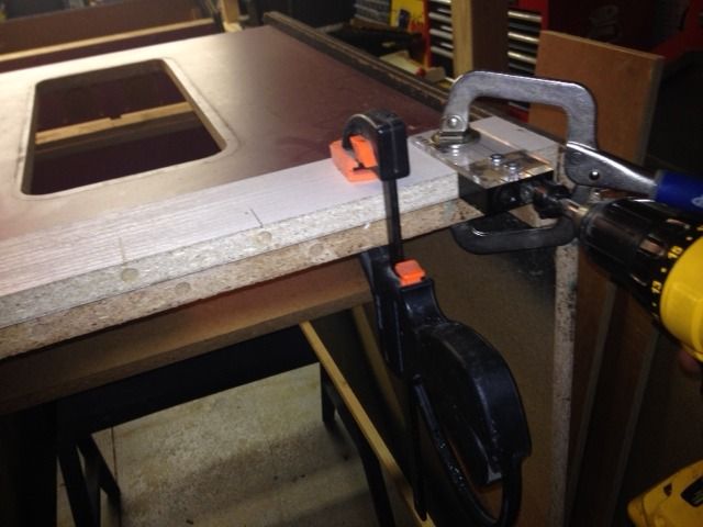

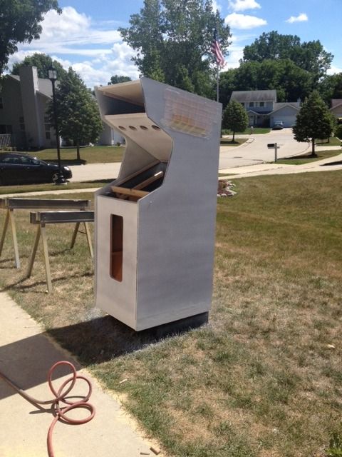

Day 2
Made new reinforcing 3/4" x 3/4" wood floor reinforcements, new top, new rear door, and new rear lower. Mounted all
Bondo'd and sanded

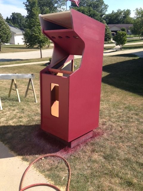

Day 4
Today I made a little progress. I sanded the primer and applied my first coat of magenta paint that I had color matched at Home Depot.

Day 4

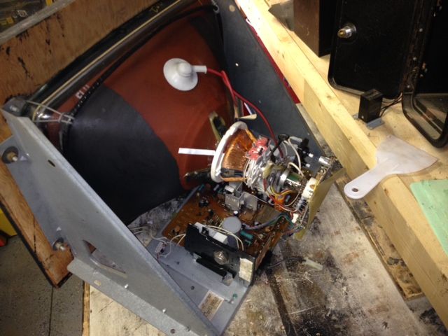

Day 5
Today, I sanded the first coat of magenta and applied a second coat. Then took the coin door apart. I took the coin doors and marquee rails off of a couple of other projects as well. I dropped all of my metal off at the powder coater. When I got home, I peeled the mask off of the original side art.
Got home from the powder coater and it seemed that the magenta paint had cured well enough that I could tape it off. I took the chance and taped the magenta sides and front panels. Then I sprayed the black. I left it in the heat for an hour and came back to spray the second coat of black. I removed the masking tape and plastic. The cabinet turned out beautifully!
