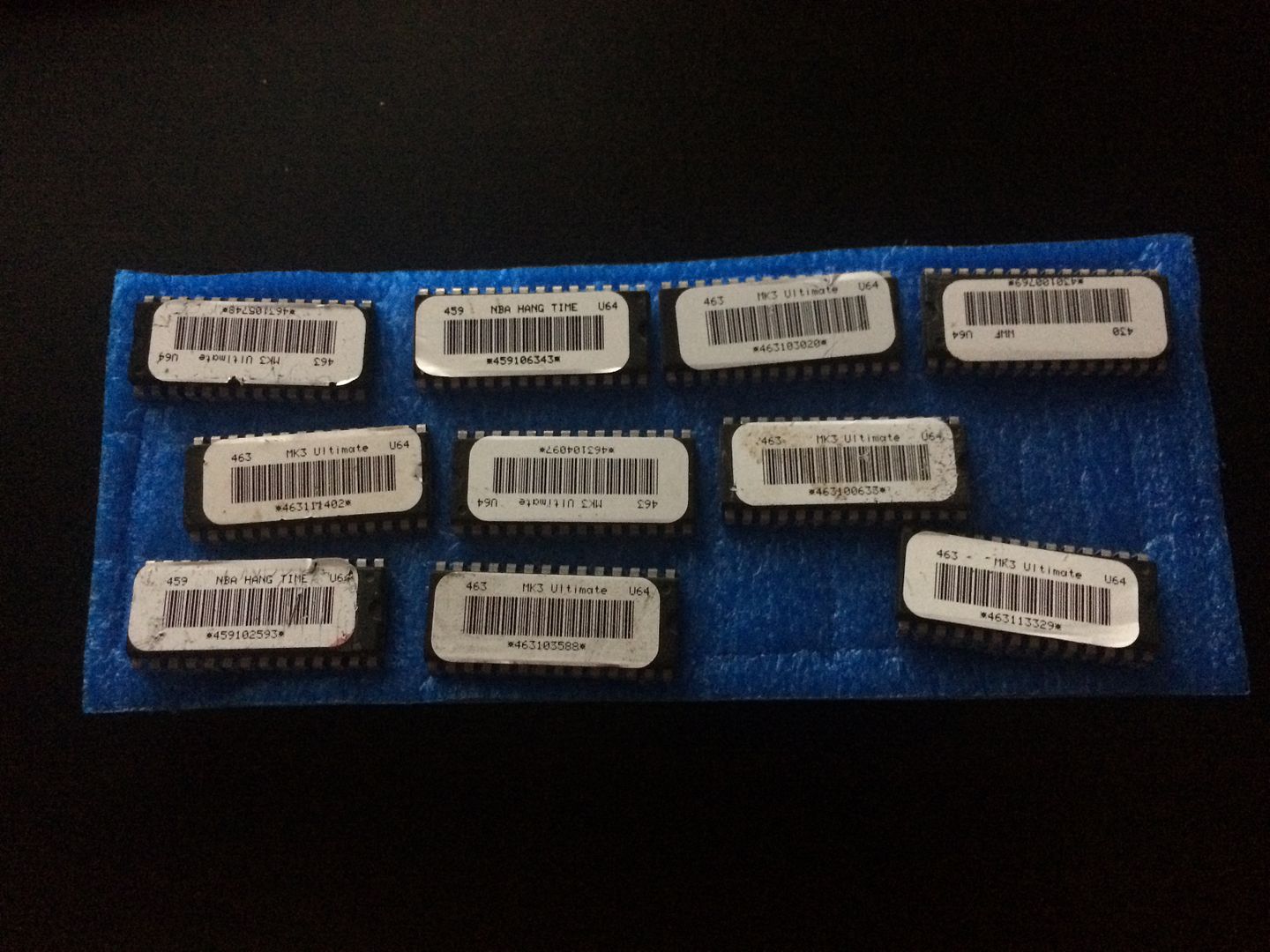

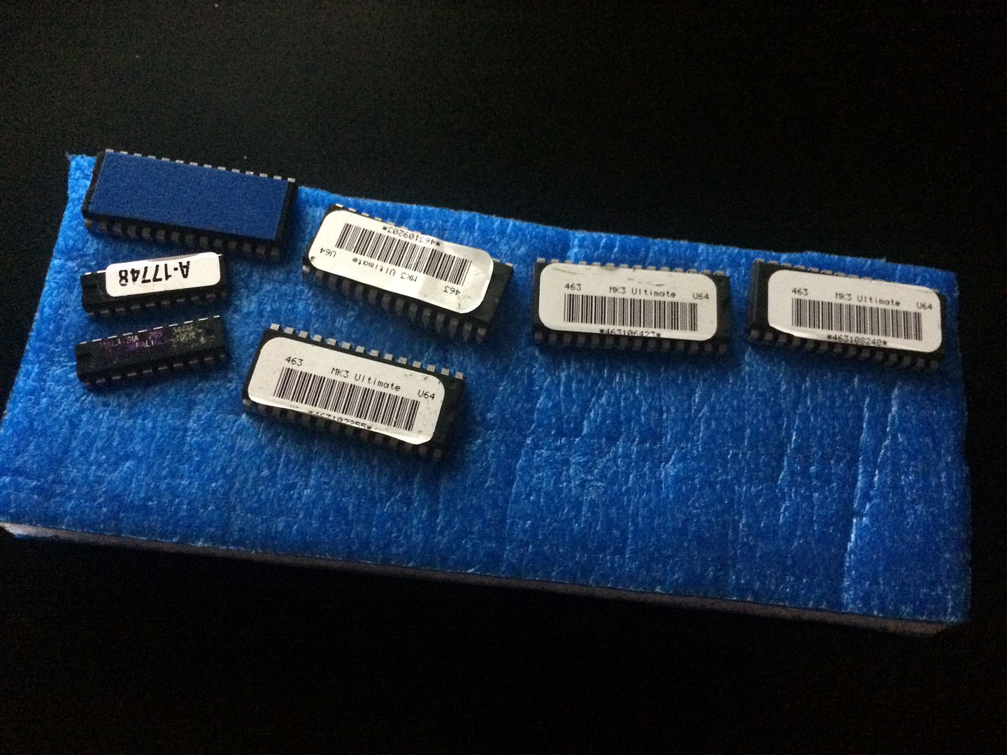

U64 is the security chip. It is located next to u54 and u63. Your board will definitely not work without that. Post a picture of the board and we might be able to help you out.

It's not as easy to program security chips. I believe Toplessz, ctozzi, and steph have the capability to do so. Reach out to one of them for the chip.

Well I tested booting the board with no security chip and I had the same symptoms as the OP. I get the initial bong but just a blank black screen. Im sure the security chip will do the trick. Who did you end up buying from, if you don't mind me asking?
Edit: I should have recommended Zeno from the get go. I should have know he had numerous spares. I was only thinking of the capabilities to burn one (which he probably does that too).

I got it from ToplessZ. I'm not sure the details but it sounded like they just exist in a finite number, not made like other eproms.
Thank you all for the help. I'm glad I've played so many years of Photo Hunt on Megatouch to realize something doesn't match lol. I AM getting a bad rom on U113 now, but I'll fix that later. Boots up and I couldn't be happier. Thanks again everyone.
