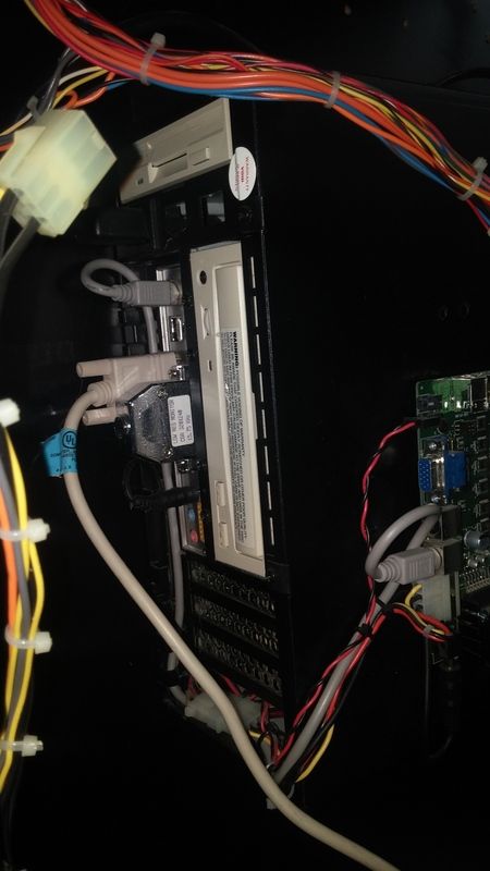

I have a ultracade that has the quantum 3D graphite computer in it. When i plug it in it sounds like the computer starts then on the screen i can tell it says something in color but the screen is rolling. Then it goes to like a white blob rolling. So i hooked the computer directly to a computer monitor, the color logo comes up then it goes to black screen that says S_CDE in white. Anyone have any idea what the S_CDE means. It is like the computer is not booting. I have hooked the monitor to another game and it works like it should. I could really use some help on this thing. Thanks

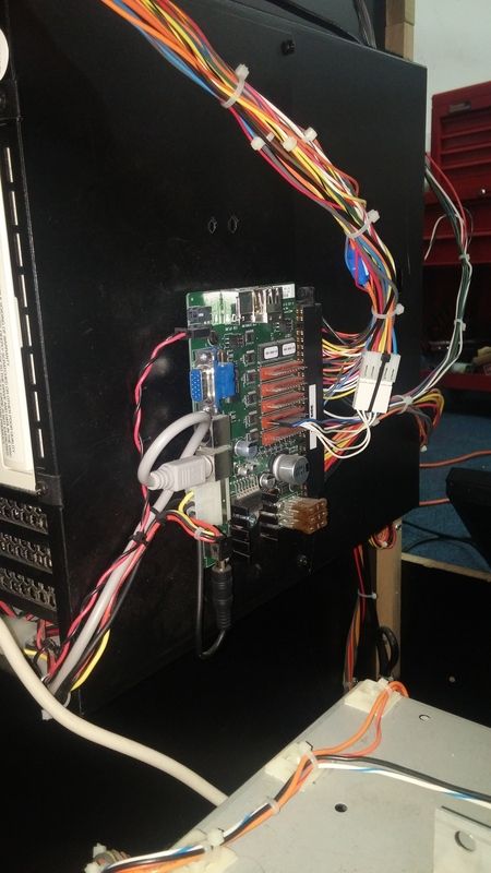

Do you know what monitor is connected? Do you have a Dongle connected to the Parallel port?
If your unsure please post some photos of the PC.

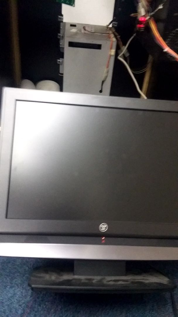

The monitor is a WG 7500 which works perfectly hooked to a bear and moose game. I think the thing hooked to the computer is a dongle. The game worked fine then all of a sudden would not come up when plugged in.
Alright. you have a good older Ultracade PC there. Well you know the PC boots as the Screen does say something.
To run the Game on a VGA monitor you need to disconnect the Silver Dongle. (There were 2 of these)
1 was CGA and the other was EGA, as you have a W7500 you "should" have the Med Rez (EGA) dongle installed. But yours is the Low Rez one..... Are you Sure you have a K7500?? Or a 7400??
To run the Game Software in VGA there should be NO dongle.
From the video your not "booting the game" Just the PC So you have hard drive corruption.
When the Ultracade system boots where you have the letters it Should read JoshuaOS kernel Loading. It is not.
How many games did you have installed? Do you have the reinstall media?
You will need the OS install CD and then the game Software, Could be CD or USB installers.
