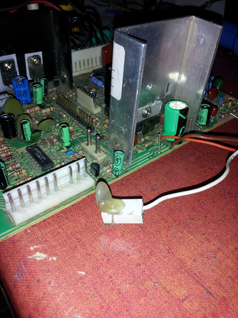

ArcRevival Well-known member VAPS Joined Aug 31, 2006 Messages 10,147 Reaction score 1,099 Location RAPID CITY, South Dakota Jul 16, 2012 #1 Can't seem to figure out where this white plug goes. It comes off the resistor that looks like it's supposed to be mounted to the heat sink. Anyone ?
CMAC New member Joined Jan 21, 2010 Messages 894 Reaction score 16 Location Michigan Jul 16, 2012 #2 That was one of the WG fixes (U5000 Vertical Sweep Upgrade Kit - S05F0000-000F). You connect the white wire side right to TP205 for 15KHz, or disconnected (empty side) for 25KHz.
OP OP ArcRevival Well-known member VAPS Joined Aug 31, 2006 Messages 10,147 Reaction score 1,099 Location RAPID CITY, South Dakota Jul 16, 2012 #3 Ok thanks, so it's not needed for Medium Res "mode".
