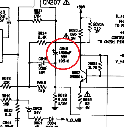

So, I don't currently have a U5000 cap listing on my site, and I'm working on some today, so I decided to make the listing (even though I have in the past but can't find it now).
Anyway, the first cap I pull is C117, which is a 22uf 50v. I check the part listing in the back of the U5000 Service Manual and it shows it as a 10uf 50v. :confused: I then check the U5000 Schematic and it shows it as a 22uf 63v. :rolleyes:
Okay, so I match the new part to the schematic and put that on my listing.
Then I come to the next part - C725. This cab has had the label coating come off. I check the Service Manual and it shows a 100uf 50v. I then check the schematic and it shows a 22uf 100v. I then check another U5000 chassis and it shows a 22uf 100v, so that has to be right.
Seems to be quite a few part discrepancies between the service manual and the schematic, so I'll be having fun doing verifications to make sure the listing is accurate.
Just an FYI in case anyone gets a cap kit from someone that was based off the service manual instead of the schematic...

C700 was a 220uf 16v. Service Manual lists it as a 220uf 16v. Schematic lists it as a 47uf 16v - same as C600 (which is listed as a 47uf 16v in the Service Manual). Now, the other U5000 chassis has a 220uf 16v cap there.
So - Is it possible the Service Manual is an updated listing with part mod updates? C700 is in the horizontal sync input circuitry, and C600 is in the vertical sync circuitry.
It also lists C616 as a 1000uf 50v instead of the normal 1500uf 35v that was original, and Bob"s cap kits always put 1000uf's in for that location.
Should I base my listing off of what the schematic says, what the parts listing says, or what is actually there? Unfortunately, this chassis had been worked on in the past, so there is no guarantee that these parts were original...
Okay, I dug out a U5000 that had never been worked on, and it has a 220uf 16v cap there, so that's what goes on the list. It has caps that match the schematic for C117, C616, and C725 also.
So - I guess I'll refer to this untouched chassis for my listing if there is a discrepancy...

Going through mine again and I am wondering about c616. You have a 1500uf, mine has a 1000uf, Bob's kit says 1000uf or 2200 uf depending on the monitor, u5000 manual says 1000uf, wondering if your 1500uf at c616 is a typo ?
Edit: My c810 was not populated. Bob's kit shows like yours with a 10uf63 there but nothing in the k7400 or k7500.
Double Edit: Looks like my 10uf63 is soldered across the bottom of Q808.
Like I said in the 3nd post (I think), the manual's parts list shows a 1000uf, which is commonly used during a rebuild because a lot of parts suppliers don't stock a 1500uf cap, but the schematic shows it was originally a 1500uf cap, which is what I order and use, and which is why it's listed on my cap listing:
