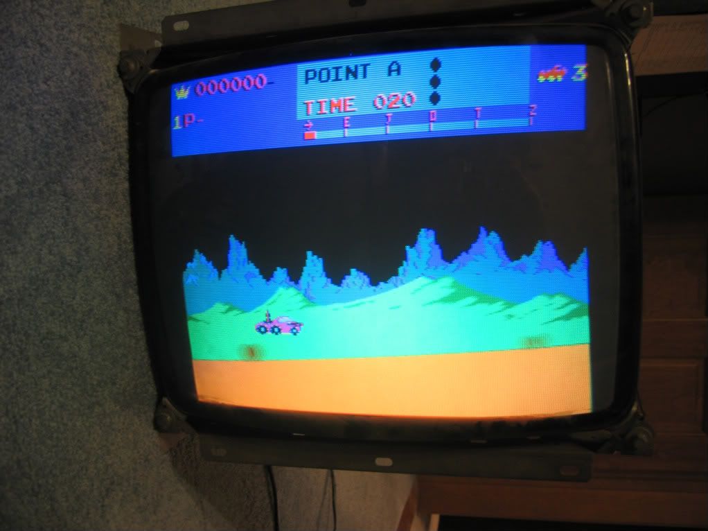

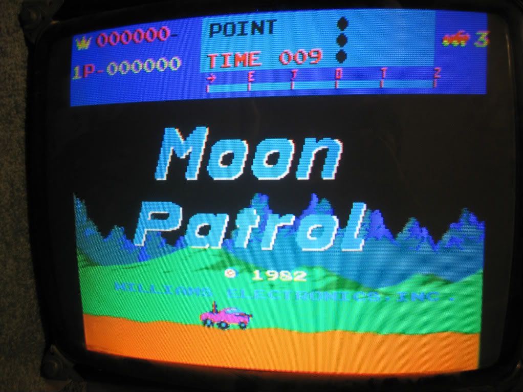

I have a bunch of these 19" TVs that were going to get recycled and decided to show my results using a new chassis with them. I was very impressed with the picture although it was not perfect but at a time of CRTs getting scarce this is kinda promising and not very expensive. This is a low impedance Wei-ya 1220 series chassis with a built in ISO an ran me about $65 shipped from Alva Amusements. The horz coil is maxed out and I was wondering if anybody would know how to hack the board to get the picture a tad smaller. Anywho here it is with the stock yoke and rings in place.

As to the width problem there is a width range jumper wire on the main board to select (N) narrower or (W) wider.
The Wei-ya 1220 series definitely REQUIRES operation from an isolation transformer.
My bad, it's a 2620S model! Yes Ken is correct the 1220 does need an ISO. The TV I used is a 1988 Magnavox but I also have a bunch of 1993 Crowley's also. I believe they all have Phillips tubes in them. The yokes in both TV models have a IMP of 14ohms on the vert and 5ohms on the horz which is damn close to a WG7000 yoke but still will not work with a 7000 for some reason.
