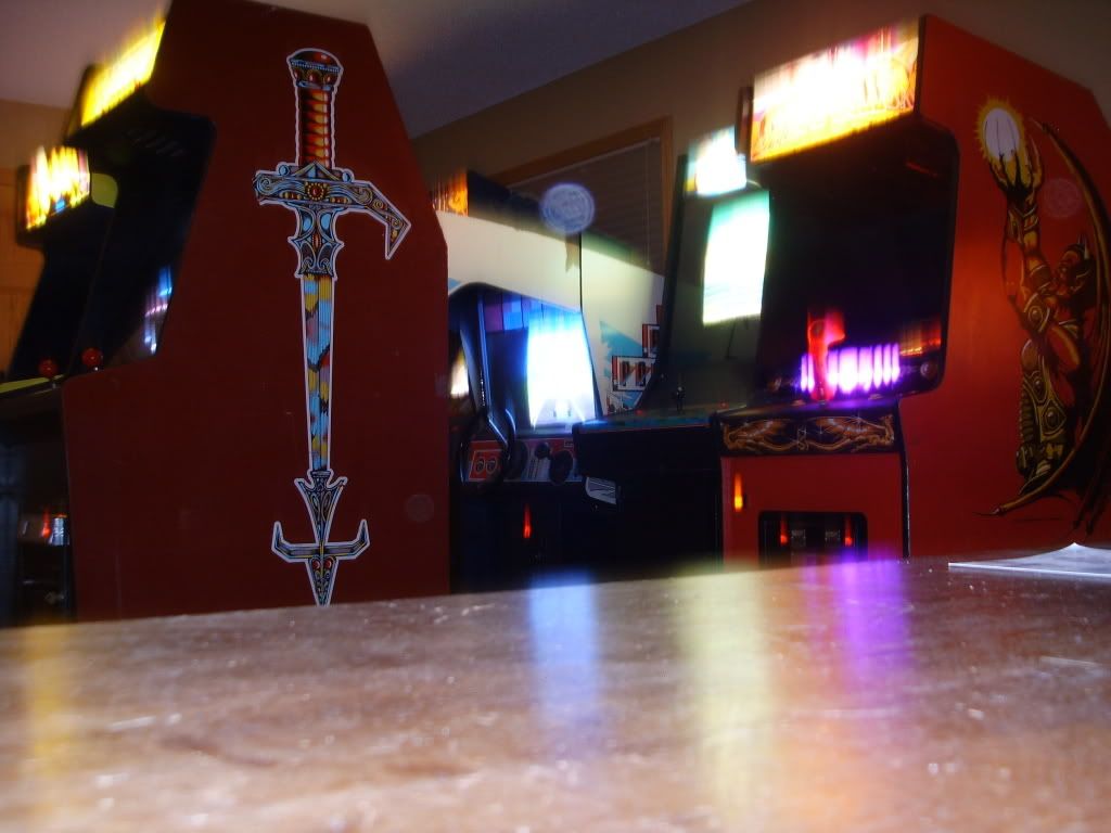

Thanks again to Herbertsmart for finding and parting with this super nice Tut. This is a sweet game with very interesting cabinet with cool wrap around marquee. This machine is in very nice condition, nearly complete sword sideart on one side. CPO is nice and screen is beautifully vibrant.
I haven't played this game in a dedicated cab since the early 80's and still love it. I was never good at it, but could still easily get to the 3rd set of screens tonight. The machine does have a very loud buzz/hum but - anyone know what might be causing that? It still plays the background tune and has sound affects, but it's accompanied by a loud hum.

the hum could be from ac voltage creeping in to the dc voltages.
Check the edge connectors and clean the pcb edge traces, and clean the contacts in the
connector.
perhaps recapp the power supply, possible the caps in the audio portion of the pcb may
need replaced.
check / replace any volume potentiometers.
sometimes the ballast in the marquee can also create interference if it is going bad.
